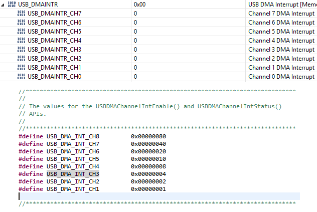

  • Hi again Amit,
    I was able to fix my issue with adding a watch expression for the status of the register. It looks to be the case that there is a discrepancy in the way the USB_DMAINTR register is indexed and the way that the tokens for determining the interrupt that was triggered. I have attached some screenshots below showing the issue.
    Bryan

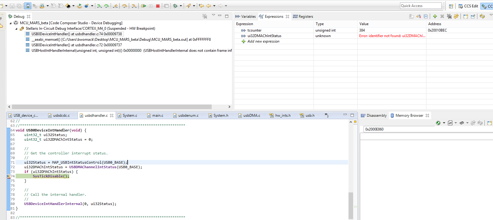

  • Hello Amit,
    Good suggestions, but the problem with the watchpoint was not that it was reporting zero. It seems there is an issue related to CCS that doesn't allow the setting of watchpoint's for certain expressions. It said that it was unable to recognize the expression so I moved the variable to be a global variable within usbhandler.c and I was able to see the variable and confirm the issue.
    It would be nice to have a breakpoint on the line of code right before USBDMAInterruptStatus, but the USB handler actually gets called quite often during the setup of the device and it causes strange issues with passing descriptors to windows when I spend too much time stepping through and waiting for the interrupt to be related to DMA.

  • Hello Amit,
    Here is a screenshot of the issue with assigning a watchpoint to the value of the DMA Interrupt register:
    Cheers,
    Bryan

  • Hello Amit,
    Only the variable ui32Status shows up in the variables tab. I have already "resolved" the issue by putting the declaration of ui32DMAChIntStatus to a larger scope than just the usbhandler function.
    Bryan

    I am sorry I think we have a misunderstanding. I already noted that I am able to see the value of ui32DMAChIntStatus at this point. I thought you wanted to see the issue I was having with setting a watchpoint for the variable. I just took away the modifications I made to my code to reproduce the error and show it to you.
    The issue I was having earlier was solved because I was trying to stop the timer when the DMA Interrupt status was "USB_DMA_INT_CH3" when I should have been using "USB_DMA_INT_CH4". For some reason as per the first screenshot I posted, the Tivaware library defines the interrupt status tokens with a 1-based index so it goes from DMA channel 1 to DMA channel 8. The actual case is that there are DMA channels 0 through 7.
    Because of this, it is required to use the token "USB_DMA_INT_CH4" to check for the DMA interrupt for DMA channel 3. I was able to confirm this by fixing the watchpoint and observing that the hex code on the interrupt was 0x08 which corresponds to the token USB_DMA_INT_CH4.
    Bryan
  • Hello Bryan,
    OK, yes there was a confusion and that you are right that the DMA channels 0 to 7 have been defined as 1 to 8 in the define.
