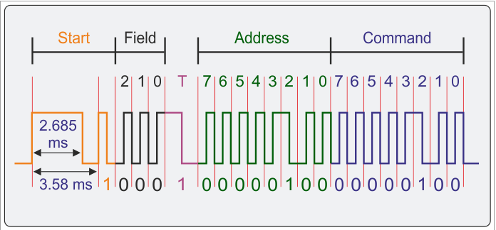

Here is the specification of RC6:

  • The code to trigger the message coming from remote control for infrared RC6:
    int main(void)
    Board_initGeneral();
    Board_initGPIO();
    SysCtlPeripheralEnable(SYSCTL_PERIPH_TIMER3);
    TimerClockSourceSet(TIMER3_BASE, TIMER_CLOCK_SYSTEM);
    GPIOPinConfigure(GPIO_PM2_T3CCP0);
    GPIOPinTypeTimer(GPIO_PORTM_BASE, GPIO_PIN_2);
    TimerConfigure(TIMER3_BASE, TIMER_CFG_SPLIT_PAIR | TIMER_CFG_A_CAP_COUNT);
    TimerLoadSet(TIMER3_BASE, TIMER_A, 4);
    TimerMatchSet(TIMER3_BASE, TIMER_A, 0);
    TimerControlEvent(TIMER3_BASE, TIMER_A, TIMER_EVENT_BOTH_EDGES);
    TimerIntEnable(TIMER3_BASE, TIMER_CAPA_MATCH);
    IntEnable(INT_TIMER3A);
    IntMasterEnable();
    TimerEnable(TIMER3_BASE, TIMER_A);
    BIOS_start();
    extern "C" void hwiTimer2AFxn(void)
        TimerIntClear(TIMER3_BASE, TIMER_CAPA_MATCH);
        Swi_post(swiTimer2A);
    extern "C" void swiTimer2AFxn(void)
        GPIO_toggle(Board_LED0);
        Log_info0("swiTimer2AFxn");
    And you know that in .cfg file you should create a hardware interrupt for INT_TIMER3A which is basically the value 51.
    The problem is that it gets only the first interrupt.
    I think something should be reset also after the first interrupt.
    I am checking and come back with a post.
