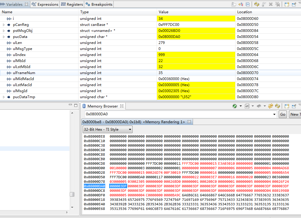

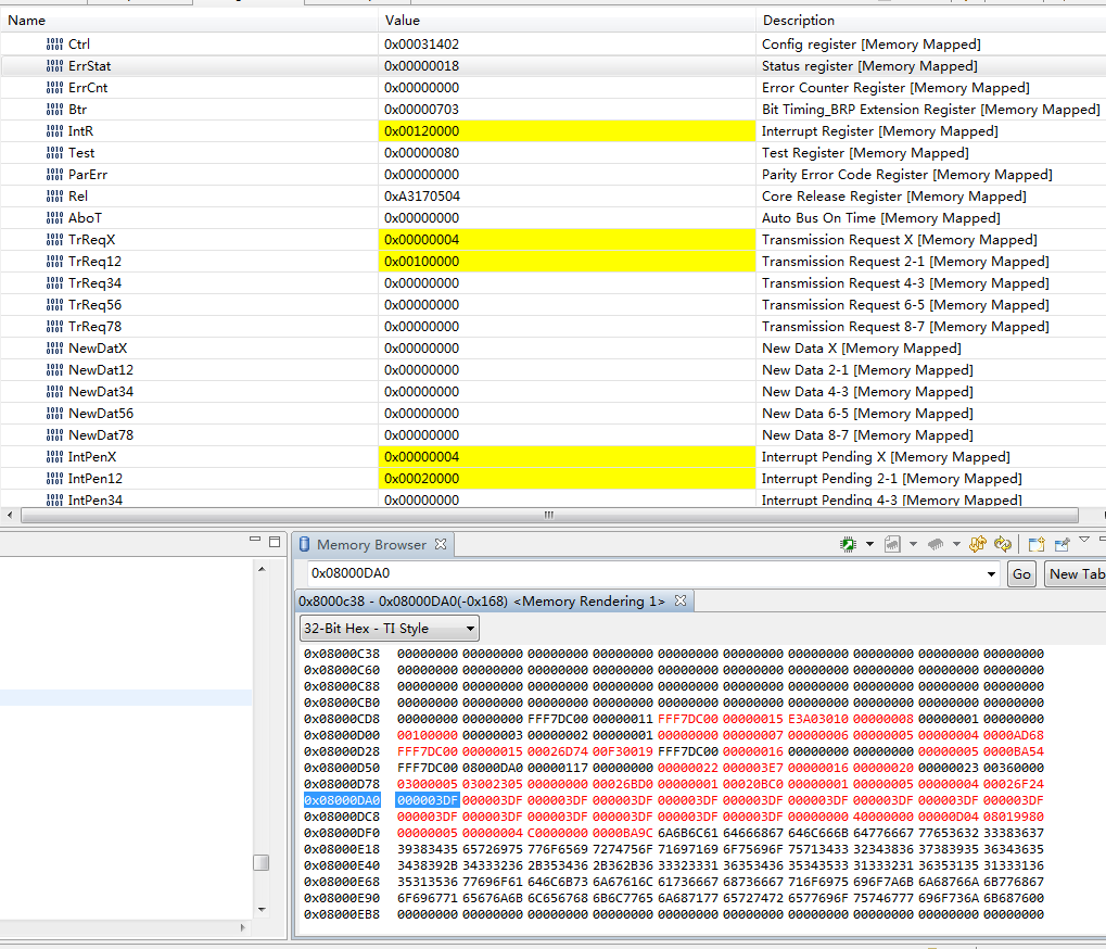

I using 570 can bus send message. Message box configuration as following: No 18-32 for TX, polling send msg. When i send more than 30 message frames, There was an Interrupt in message box 18, and change the data in stack where is used to store the msg configure data. Send msg data code as following:
    for(i=0;i<ulFrameNum;i++)
          ulMsgId = 0;
        ulMbId = canMESSAGE_BOX18+i%(canMESSAGE_BOX32-canMESSAGE_BOX17);
        while(canIsTxMessagePending(pCanReg, ulMbId))
        if(i==29)
        if((i>0)&&(i%15==0))
            ulLstMbId = (i+15-1)%15+18;
             while(pCanReg->TXRQx[0] & 0xfffe0000)
        ulMsgId |=((ulMsgType&0xF)<<24);
        ulMsgId |=((ulFrameNum&0xFF)<<8);
        if(i==ulFrameNum-1)
            ulMsgId |= ulLstMacId;
            if(ulLen%DATA_FRAME_BYTE_NUM==0)
                pstMsgObj[ulMbId].ui32MsgLen = DATA_FRAME_BYTE_NUM;
            else
                pstMsgObj[ulMbId].ui32MsgLen = ulLen%DATA_FRAME_BYTE_NUM;
        else
            ulMsgId |= ulMidMacId;
        ulMsgId |= (i&0xFF);
        pstMsgObj[ulMbId].ui32MsgID = ulMsgId;
        pstMsgObj[ulMbId].pui8MsgData = pucDataTmp+i*DATA_FRAME_BYTE_NUM;
        CANMessageSet(pCanReg, ulMbId, &(pstMsgObj[ulMbId]), MSG_OBJ_TYPE_TX);
The data in register and ram before msg 18 interrupted:
The data in register and ram after msg 18 interrupted:
    1. You need to enable the TX interrupt (high priority or low priority) for Message 18,
    2. Enable DCAN interrupt (DCAN0INT or DCAN1INT)
    3. Configure VIM to enable DCAN interrupt (channel 16 for CAN1 high, and channel 29 for CAN1 low)
    4. Set CAN interrupt to IRQ or FIQ
    Whenever the interrupt occurs, CPU will jump to ISR defined by yourself or by HALCoGen. I suggest you to use HALCoGen to generate the basic CAN driver which including the INT ISR, then you place your code to a function called notification.

  • I have checked the problem. because of the SVC stack is too small (1024B), my code was over stack. Thank you for your reply.
