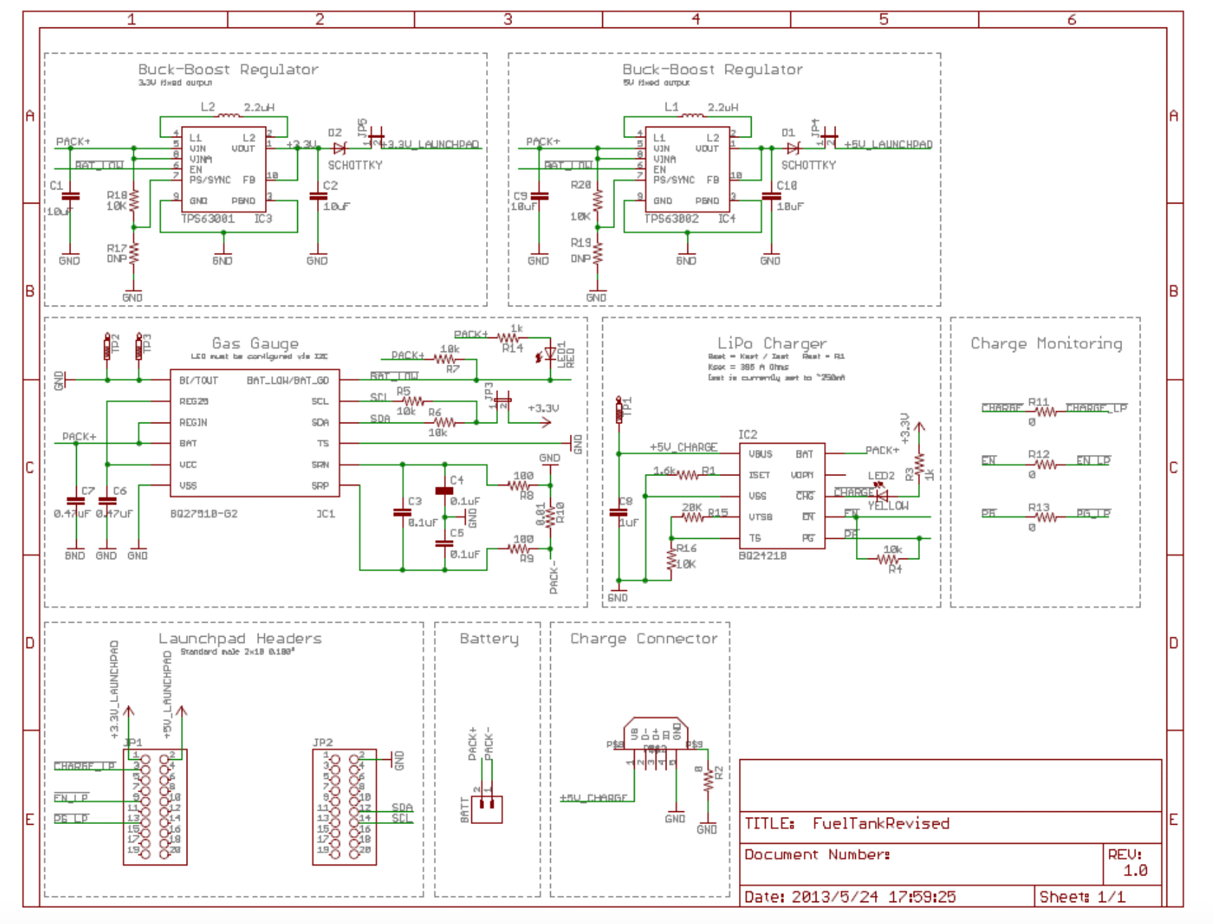

  • This is certainly more complicated than I thought it would be. I am trying to send out a PCB by the end of the day and I just wanted to double check that my external powering was correct. It seems that instead of a simple answer I've fallen down the proverbial rabbit hole.
    I have looked through the Battery Booster Pack design trying to understand at which point it interfaces power with the tiva launchpad. It is still hard to figure out an answer. For instance, Section 3.3.1.1 (Launchpad Jumper Settings) states "Ensure that jumper P1.0 is closed and P1.6 is open on the MSP430 LaunchPad." followed by a picture of the launchpad. This picture is unlabeled and I have no idea which jumpers p1 and p1.6 it is referring to.
    So I skipped to the Schematic to see if I couldn't figure it out. I payed close attention to the two Regulators at the top of the schematic. The 5V regulator on the right takes in voltage from the LIPO battery pack and outputs to 5V to JP1 Pin 2, which is definitely the VBUS pin. Seems like this is the answer. However, the 3.3V regulator on the upper left side of the schematic takes in voltage from the LIPO Battery Pack as well, and outputs 3.3V to JP1 Pin 1, which I know is a 3.3V output pin. So I find myself still unsure.
    I'm about to take this all to my professor. He's designed carrier boards for the tiva launchpad before, maybe he'll have answer for how on earth I do this...

  • A proper switching regulator sounds fine. My only question at this point is where you input that proper 5V to. Does that 5V go to VBUS? A header on the board? Therein lies the question.
    Edit: Just checked with my professor, who designed a protection/breakout board for the tiva launchpad. 5V on the VBus line is what you need to power the tiva launchpad. So yes, I'll regulate down a 7.4V lipo down to 5V (Cb1, at your suggestion I'll consider a more sophisticated regulator), push it into VBUS, and call it a day.
    Thanks all.
  • Hello Zero PD,
    Do note that in the case of Battery Booster Pack, the power is being supplied from the battery and not the VBUS.
