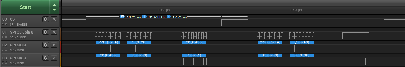

SPI clock sporadically does not transition on a TMC4123BE6PZ
We are getting some returns from the field.  I started to question whether the SPI traffic was working.  I grabbed some traces and found that sporadically the SPI clock seems to fail to transition low.  The circuit does not have any pull up or pull down resisters on any of the lines.
I find nothing in the errata for this chip about the serial clock.  I did not get any hits searching e2e.
I cannot explain why the transfers work > 99.5% of the time.
Is there experience of the SPI clock not transitioning?
The code that generates the following is included below.

  • Hello John,
    There is no known mechanism where such a case should be possible. However, if you could share the SSI settings and the target device information, I would be able to help better.

  • Merged snippets below on the SPI setup
    UINT32 sysCtlClock; // Port A // PA0 CAN1Rx (reserved), used for debugging UART for now and on EKS board // PA1 CAN1Tx (reserved), used for debugging UART for now and on EKS board // PA2 SSI0Clk - MiWi-SCK1 // PA3 SSI0Fss - MiWi-Fss - not used // PA4 SSI0Rx - MiWi-Rx // PA5 SSI0TX - MiWi-Tx // PA6 IN13 - MiWi-INT // PA7 IN14 - NC ROM_SysCtlPeripheralEnable(SYSCTL_PERIPH_GPIOA); ROM_GPIOPinTypeGPIOInput(GPIO_PORTA_BASE, GPIO_PIN_6); ROM_GPIOPadConfigSet(GPIO_PORTA_BASE, GPIO_PIN_6, GPIO_STRENGTH_2MA, GPIO_PIN_TYPE_STD_WPU); // WRLS will be using INT on PA6 // Use GPIO_LOW_LEVEL as interrupt may be disabled in main code, but // when re-enabled, needs to generate the interrupt ROM_GPIOIntTypeSet(GPIO_PORTA_BASE, GPIO_PIN_6, GPIO_LOW_LEVEL); ROM_IntEnable(INT_GPIOA); // Now setup the SSI0 pins ROM_GPIOPinConfigure(GPIO_PA2_SSI0CLK); //GPIOPinConfigure(GPIO_PA3_SSI0FSS); ROM_GPIOPinConfigure(GPIO_PA4_SSI0RX); ROM_GPIOPinConfigure(GPIO_PA5_SSI0TX); ROM_GPIOPinTypeSSI(GPIO_PORTA_BASE, GPIO_PIN_5 | GPIO_PIN_4 | GPIO_PIN_3 | GPIO_PIN_2); // Set unused pins to output and set low ROM_GPIOPinTypeGPIOOutput(GPIO_PORTA_BASE, GPIO_PIN_7); ROM_GPIOPinWrite(GPIO_PORTA_BASE, GPIO_PIN_7, 0); SysCtlClockSet(SYSCTL_SYSDIV_2_5 | SYSCTL_USE_PLL | SYSCTL_OSC_MAIN | SYSCTL_XTAL_20MHZ); sysCtlClock = SysCtlClockGet(); // Enable SSI ROM_SysCtlPeripheralEnable(SYSCTL_PERIPH_SSI0); ROM_SSIConfigSetExpClk(SSI0_BASE, sysCtlClock, SSI_FRF_MOTO_MODE_0, SSI_MODE_MASTER, 4000000, 8); ROM_SSIEnable(SSI0_BASE);
  • I added a single line of code to use PIOSC as the SSI clock source. The CLK signal is now clean.
    Any thoughts on this new information?
  • System clock is at 80 MHz off of a 20MHz crystal and using the PLL.
    SPI bus is at 4MHz.
    CORRECTION:  When I switched to the PIOSC, the SPI clock dropped to 800khz.  When I 'corrected' that and the source is PIOSC and SPI clock is at 4MHz, the clock corruption comes back.
  • Assuming you are supposed to get the same result back in both cases, it's not just the clock that looks odd. The bit from the peripheral is also odd. It's too short (there's no clock edge near where it is rising). Hmm, you have measure this with a logic analyser?
    Suggestion: instead of clocking 0 during the read phase clock out alternating bits. If the clock is indeed stopped you should see a DC level. The fact you don't see a DC level on MISO makes me think you might indeed have a clock.
    Robert
  • Hello John,
    When the source clock for the SPI is PIOSC, then have you changed the following configuration line so sysCtlClock is 16000000?
    Amit
  • I found the issue: pilot error on the logic analyzer. Using a 8MHz logic analyzer not connected to anything to analyze a 4MHz signal is not a good move. Nyquist can make a very good 4MHz clock look bad. A 500MHz scope showed that the SPI was as expected.
