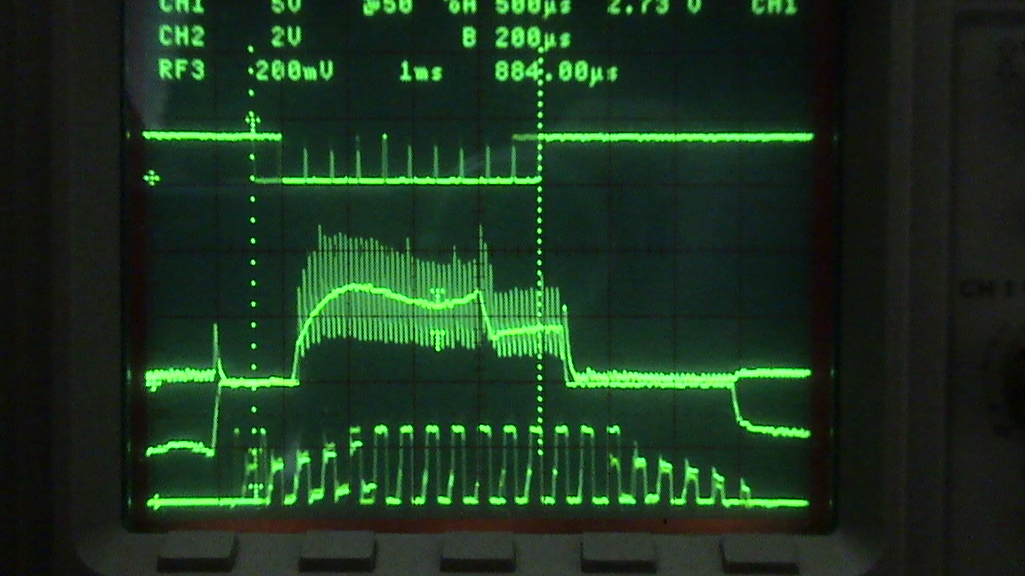

    The thing that surprised me most is the ADC is not triggering with every PWM pulse on Phase 1 test probe. Seeing instead 3 periods of ADC sample interrupts and expecting zero load trigger was occurring with every PWM pulse period. Seems current is not being sampled as often as I had believed it was. That may be due to original code only configured one generator for PWM load count trigger versus having all 3 generators configured to drive an ADC trigger pulse on anyone of them reaching load count zero.
    Any thoughts on why there are only 3 ADC sample period over the entire trapezoidal wave form?

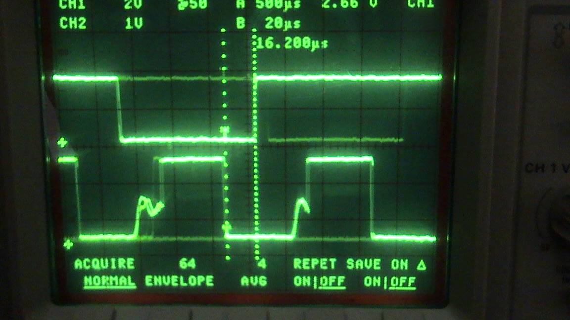

  • Hi Amit,
    >That value dropped from 8160ns to 1160ns multiplying latency alone.
    Odd thing is the scope timings 1660-1680ns ADC trigger to interrupt times appear closer to 1160ns. Perhaps that formula is not very reliable as first believed.

    The 3 pulses were due to where the GPIO assert was placed inside the BEMF edge detection SW but later discovered the very same three edges were present in current detection SW period. As a result the ADC SW was only providing export current updates at 3 places in the trapezoidal wave form; beginning middle and end.  That occurs when testing the phase current index (!=) previous phase current index. Setting that index test to (>=) the current sample positions mirroring PWM pulses but the first edges of 12 sample interrupt pulses moves to the center of the trapezoidal wave following it to the end.
    Which is better 3 current export interrupts spaced evenly in the trapezoidal wave form or 12 pulses from center to end?
    Not really sure if the PWM cycle refers to the entire trapezoidal wave form on each phase or the individual PWM pulses in the trapezoidal wave form. Some clarification on terminology would go a long way in understanding ADC phase current samples. Term cycle by cycle current limiting from the BLDC perspective might infer the entire trapezoidal wave. From the MOSFET perspective that might infer gate drive time and DS pulse period avalanche current. The former 3 pulses seem plausible would produce an average BLDC current update where 12 pulse would produce rapid updates center to end of the trapezoidal wave form forcing sudden duty cycle updates in the avalanche current output. Which one is better or safer?

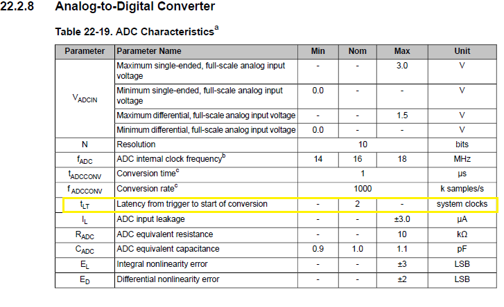

    One final point - earlier you noted "2 MCU clocks" as the ADC's "latency."   Yet - a better review of MCU spec reveals that those "2 clocks" are a "typical" value - thus, "Not cast in stone!"   And - the PWM Generator may be placed in, "Edge or Center" mode - which further confounds & complicates (even your) "best deduction" - does it not?

    Again the  ADC aperture you speak of was only being tested 3 times during the entire phase wave form generation. Note worthy is the latency calculation time period did not increase with the conversion time factor 2x,4x,8x rather could be greatly reduced. That said, something ain't holding true to deductive reasoning. Most notable as HWA factor value is decreased or set to zero the SW total latency period must be increased or the BEMF timer trigger zero crossings were late and motor would not start.
    The question is why LMI only sampled current 3 times over the entire trapezoidal wave form? The Opamps and INA282 are keeping pace with each PWM pulse but the ADC and SW was not. I think this can be improved greatly to sample each and every PWM pulse as it should be doing with (pwm_trg_cnt_load) yet is not.
    Scope top trace GPIO port - middle INA282 205kHz pulses superimposed over Hantek have same 884us period as GPIO. You can see the first PWM demagnetization pulse in both INA282/Opamps. Otherwise the GPIO would only pulse 3 times with the current index being incremented by only GEN0.
  • BTW: The latency 20us or 2 system clocks in datasheet lines up with pwm_trg_cnt_ld (^ each PWM pulse) is also the time from trigger to sample start based on 0x HWA + 1us conversion time. So the formula is as Amit pointed out and the scope concurs 20us*8x = 160ns+1us=1160us and 1660usns up to the GPIO 1st pulse where SW exports the current calculation.
    You continue to, "Play loose w/the facts" do you not?   The ADC runs @ 16MHz (minimum) - not at the System Clock!   And the ADC's latency (listed as Tlc) is clearly described in "ADC Clocks" - NOT system clocks as you promote!
    Worse still - 2, 16MHz ADC Clocks veer far from the bp "claimed" 20µS - do they not?   (62.5nS * 2 - by this reporter's "back of envelope calc.)

  • >Really - and just how do you (capture) each/every such ADC trigger?
    In my opinion you don't need to since each every ADC trigger event occurs center of each (pwm_trg_cnt_ld) bottom trace. By the book ADC trigger is supposed to occur in the center of each PWM pulse exactly 2 system clock cycles later or 40ns @0x HWA, 160ns @8x HWA. The rising edge top trace GPIO moves to changes made in HWA factor values 2x,4x,8x etc..

  • That capture includes the time to GPIO output down in SW from the ADC interrupt entry. The capture shows the GPIO pulse is present at some exact time after that ADC trigger event took place. Given NVIC is play total time from ADC trigger into the ADC interrupt may vary and it does seem to jump ahead jitter exact position seen in the ghost on right.

  • I screwed up above math 1160ns 16.6us missing a 0 above post should be 11600ns and @8x HWA seemingly measures 16,450ns based on GPIO firing twice at the beginning of ADCIntTrap0.
    The ADC sample time seems to double going from 2x to 8x, HWA makes it appear as if the conversion time changes Ts*8x. Consider the listed 1us conversion time may be wrapped by HW and is listed to correlate with the listed sample time 1000KSPS. Only makes sense that the larger the bit size of the FIFO with higher HWA factors the longer it will take to convert and average the sampled data. After all the samples bits have to go some where in order to average the data in the end. Absent any explanation in text oversampling would seemingly store those data bits in a circular FIFO that's why we decrease in our factor of SPS by the exact amount of the conversion multiplier. Other words how can we have a useful end average if the FIFO dumps the sample data every cycle. Dumping the FIFO wouldn't make any sense so we have to hold all sampled data until the very end to average the total collected. That takes more time
    I no longer believe 1us conversion for every HWA factor than there is a man in the moon, especially when 64x HWA is in play. The HWA exponential sample time can be seen in the PWM load times extending with increases in the HWA factor.
    The stranger thing is the ADC interrupt GPIO markers all line up with every PWM pulse if the entire GPIO toggle is placed at the beginning of the interrupt. That behavior changes when the second GPIO toggle is asserted inside the current index test. We loose cycle by cycle PWM current monitor and move to 3 bit current averaging. The current index is not following every PWM pulse. It seems the C+ language to blame as current Index (>) last index renders 0 GPIO pulses And current index (>=) gives us 12 toggles while current index (!=) gives us only 3 watch points. This may be a job for pure assembler?
  • The problem with the ADC channel selector current index skipping over PWM pulses is exercised after removing the test shown below.
    I suspect the entire (if) clause takes more instruction time than the next current index pulses' arrival time, 79us at 6200 Rpm 12.5kHz PWM. The entry into the ADC interrupt every 79us as the GPIO marker proves the (pwm_trg_cnt_load) is circular after all.
    The good thing is the GPIO marker for ADC current index ends up dead center of each low side MOSFET on time for 7.5- 8us. The current index changes reading the ulPWMEnable register entry to the ADC interrupt. ADC Sample FIFO depth insures the SOA in 1ms duty cycle adjustments performed during the PWM interrupt cycle. Oddly increasing the HWA factor does widens the 3 pulses in the current index yet 3 samples over the entire trapezoidal wave form seems far to sparse to ensure the MOSFET SOA upon sudden duty changes may resort to running on the edge at times.

  • The GPIO marker is not moving the index in the low side MOS samples synchronous with the PWM pulse stream. So the same low side index point in the very same few PWM pulses are always being processed instead of processing a real time current sample in each/every PWM pulse.
    It appears as if the ADC sequencer index is not being reprogrammed synchronous with the PWM generator events. Even though the ADC interrupt GPIO marker is synchronous with each and every MOS low side PWM event.
    IE: We should be seeing a marker pulse inside each/every PWM pulse to indicate the current sample moves in real time.
    The index pulse witness GPIO placement is critical and appears to scan across the entire complex wave from even delaying the B channel trigger in the complex wave form. The GPIO pulse appears to move with the index increment in each sample step so the current 1ms update visual also has varied current peaks (hairs/points) riding the current trace signal. Prior changing the index schema the current trace remained visually flat especially HWA set 2x-8x, all the ADC sample noise disappears.
    Another interesting point is the interrupt marker index no longer captures the 1st demagnetization pulse falling edge. The current shunt amplifier was processing and passing each phases' 1st EMF pulse into the ADC sample data. The very edge of demagnetization tallest 1st pulse was previously being sampled. Now the GPIO marker edge falls just to the right of this rectified phase drive 1st and initial EMF blow back. Being at the beginning of each wave form generation we demagnetize each phase, it seems counter intuitive to sample the 1st pulse at all.
    Setting the index 24 causes instant over current fault. Experiments changes to the index value order to achieve even and distributed PWM current balance may prove beneficial to anyone with a Tektronix current probe.

  • BP101 said:
    Not sure why you keep insisting 1us when the circular FIFO is set 8x HWA
    Perhaps because of Amit's initial post - this thread,"The hardware averaging does not affect the conversion time, but it affects the latency of the final output from ADC FIFO viz-a-viz the first conversion."
    And the MCU's data sheet which reveals:
    Again - you cannot alter this "ADC Conversion Time."   We've suggested better name to describe the "post processing" you harness to this spec - but that cannot be called "ADC Conversion Time."
    The use of "personal" definitions most always fails when dealing w/others outside of your immediate group.   (and in your haste you wrote that Tlt was 2 "System Clocks" when the data-sheet lists ADC Clocks.)
    Analog Comparator can be properly set to "Clamp/Limit Phase Current" to user's desired level - we use the MCU's DAC to achieve that (another's M4) and it (alone) provides a robust "full aperture" protection/limiting - unlike your 1µS (so limited, oh so restricted) ADC measure.
    As Robert & I have emphasized - your 1µS aperture into a PWM impulse of perhaps 1mS leaves you essentially, "naked" - does it not?   Attack of those showing interest - but resistant to the bp Kool-Aid (tasty as it is) may not prove best/brightest.   (especially when those helpers/interested are RIGHT!)
  • >and in your haste you wrote that lt was 2 "System Clocks" when the data-sheet lists ADC Clocks.
    See the confusion - LM3s8971 shows same spec as 2 system clocks.

  • BP101 said:
    it seems you are correct to say 1us conversion at 1Msps but it seems the 1us is being multiplied by the factor and who is to say it is not
    No cannot agree - again as Amit & the MCU's spec plainly state - the ADC Conversion Time "IS - and Shall REMAIN" at 1uS!   You cannot alter that.   Your subsequent "read" of ADC data will extend the time from "Conversion ordered" - but that (extra, post-conversion, MCU processing is not defined as ADC Conversion!)   Note that Amit works (presently) in the industry - and I (past) worked similarly - yet you "hold" to your "re-write" of "ADC Conversion."
    I made the time/effort - earlier here - to greatly detail our (past) vendor FAE sanctioned experiment - in which we injected unique analog levels into the ADC - for precisely timed periods - and this effort (not deduction) confimed the 1µS which you so struggle to resist.   (and/or rename - to your purposes...)
    Pardon but you are incorrect.   Experimentation as we detailed will assure you - deduction - not so much...
    BP101 said:
    the sample aperture widens to nearly 16.6us when HWA is set at 8x
    Again No!   The ADC Conversion aperture remains at 1µS.   The time to add post conversion processing adds to this - yet does not fall under the, "ADC Conversion" umbrella!   (how could it - no number could then be provided as any/every post-process would have to be listed!)  Again - you are using tech terms incorrectly.   (and quite persistently!)
