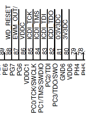

                Sorry for late reply, As per your demand I am providing you my JTAG circuit connection and providing a code used for setting the system clock. Please go through it.
    Here is the JTAG circuit connection
    And at micro controller pins
    And here is the code used for JTAG

    Is Pin 5 on the connector GND (symbols says so) or 3V3 as the name says so?
    Considering the issues, I would suggest using a XDS debugger with a mating header to match the 5 pin relimate as a more stable and long run solution.
    Amit
    Also the ICDI speed is too low (1000) - do not set it below 100000; 1,000,000 would be OK.
  • Hello Amit,
                PIN Number 5 is Ground PIN, and please try to reach to root cause of this issue as it is not possible for me to switch to another debugger. And I am curious to know why this is happening ? Kindly Reply
