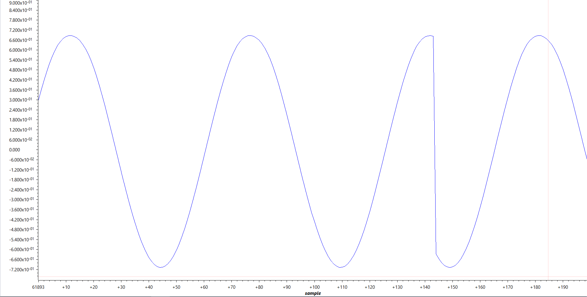

I designed a board that gets 24 Bit ADC data from external ADC using SPI communication. SSIClk runs on 8MHz and my MCU sends 4 MHz clock from PWM pin to ADC clock pin input and output data of external ADC is 3.4 kbps. I use Freescale SPI Mod(1,1) four wire communication.
I sample 50Hz pure sin wave. After proper communication, I can get 24-bit ADC data. MSB bit is signed bit in 24-bit frame. But sometimes I get wrong data or I missing data. I keep ADC data in one test buffer to observe my sine wave. As you can see in below picture, ADC data suddenly drops to minus value and continue with it.
Y-axis is RMS value of 50 Hz pure sine wave. It is only per some scale of raw 24 bit ADC data.
I checked my Chip Select signal which initiates and teminates communication between ADC on oscilloscope. It is as expected.
I get ADC data with interrupt. I also checked it. It is as expected too. I dont know where I'm going wrong.

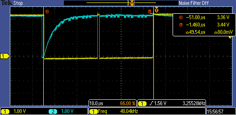

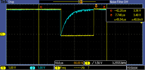

    I realized on scope that sometimes CS signal goes wrongly low to high and after it goes high-to-low as you can see in below scope screen. This happens in continous read mode. Normally one CS signal should be in line when DR falling signal is sensed.
    Normally It looks like below

  • Hello Robert
    Firstly Blue trace is data ready signal of ADC. Yellow one is Chip Select signal.
    Secondly ADC triggering starts with the interrupt. This interrupt is the falling edge of Data Ready pulse of ADC. When I get falling edge from Data ready pulse, I make chip select of ADC low and thus I trigger the ADC conversion. After I get 3X24 Bit ADC value from ADC, I make Chip select signal high.
    As you can see in graph, sample data between two sin wawe top is 65 sample. I get theoretically 3255kbps. It means frequency of my sin wave = 3255 / 65 = 50.07 Hz.

    Looking at the snapshot it seems that a stray interrupt is being sensed on the RDY. Can you try increasing the Pull Up Strength so that RDY line rises sharply, or clear the interrupt of the GPIO after the SSI Data has been processed in the interrupt handler
    Amit

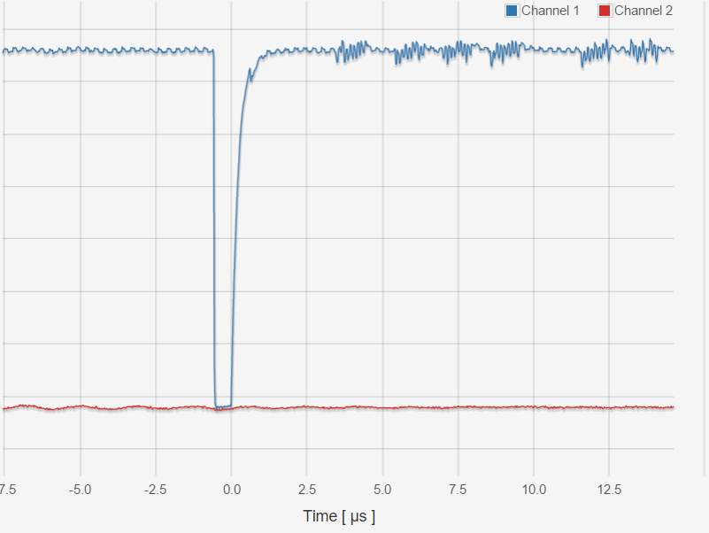

  • Hello Amit
    I moved GPIO_PORTE_ICR_R = 0x10; line after SSI data has been processed but problem is not solved.
    I dont know how I can increase pull-up strength of data ready pin. 100K pull up resistor tied to VCC in data ready pin. 100K value is suggested in datasheet of ADC. Do you think missed data or problem that occurs in plot ADC data graph is related with this wrong chip select problem ?

  • 1: Blue trace. I was afraid of that. That is a problem, that rising edge is way too slow. You either need a Schmitt trigger buffer or a stronger pullup if is open collector or both.

  • Hello
    I am sure about 100K. It seemed also so weak to me. I changed now to 4K7 and data ready signal is sharper now as you can see in below pic
    ADC is MCP3919 3 channel 24 Bit ADC. Data ready sharpness problem solved but  reading problem still continues.
  • Better but still too slow, I think. I think you need a Schmitt trigger buffer, and the other questions are still outstanding.

  • In addition to the good advice provided by Robert & Amit - and in light of the (just arrived) revelation that you are continuous clocking the ADC via the MCU's PWM signal - can that PWM signal be (fully/properly) released from your, "suspect list?"   (your scope's 3rd channel should monitor the PWM output - which clocks your ADC - to establish it's "alibi.")
    Another point - we see 2 full sine wave periods prior to your signal's, "steep dive."   Would it not prove useful to extend your trace time-span - and determine if that "steep dive" occurs consistently - and (possibly) at a regular rate?   (such may indicate an overflow or some form of "disorder" in your ADC clocking.)
    I noted from square one - yours is a 24 bit ADC - and those require very, very special pcb layout, signal routings, and most proper decoupling and powering.   Is your's a "Pro" (factory) board?   If homemade - please tell us it's not on a breadboard - or worse.
    The fact that your graph reveals (at least to me) two apparently good measurement cycles - and then goes "haywire" - leads me to doubt your clocking or perhaps even your MCU's ADC buffer strategy and/or implementation.   My quick read could not find that detail - may prove useful...

    It looks like my graph. Because in my graph sin wave firstly seems normal  then there are missed data and after it continous with new data suddenly. Maybe there can be a problem with PWM signal that I can not see.

  • Hello Friends
    After 2 day hard working on this issue, after changing only test buffer size to certain scale of 50 Hz sampling size, problem solved. All problem was related with my plot settings.
