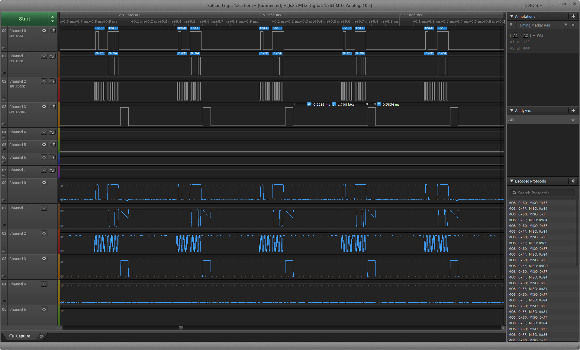

I  am having problems receiving data from ssi1 port on the TM4C1231H6PM. The data that I receive is zeros from SSIDataGet.  The SSI1 ports  are connected to AD7190  chip from Analog Device.  I have successfully set up the AD7190 on the TM4C129. Now, I am trying to port the setup onto the TM4C1231H6PM.
I think that I have set up the code ,correctly. I have posted the  setup code below. The FSS is setup as an output pin. The function called ADC_ID  should return the ID register value from the AD7190 chip but it returns zero. Next, I hooked up the SSI1 RX line to a logic analyzer and observed that I am receiving data from   the AD7190.
Also, I have posted the functions SPI_BUS_Send and SPI_GET_DATA to show that I am managing the FIFO buffer with SSiDataPut and SSIDataGet.
I have been stuck on this problem for days and decided to finally post on to forum. Any suggestion or advice would be helpful.
