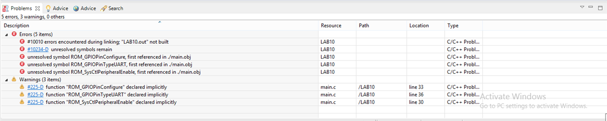

I'm trying to use ROM_ functions to initialize the following code:

but when i try to build i get the following errors:
If I remove the ROM_ before the functions or change it to MAP_ the code compiles and runs without any problem.
What do I have to do to use those functions?
  • Hello Leonardo,
    Since you may be using a TM4C1294x device, you need to add the define TARGET_IS_TM4C129_RA1 during compilation.
    Amit
