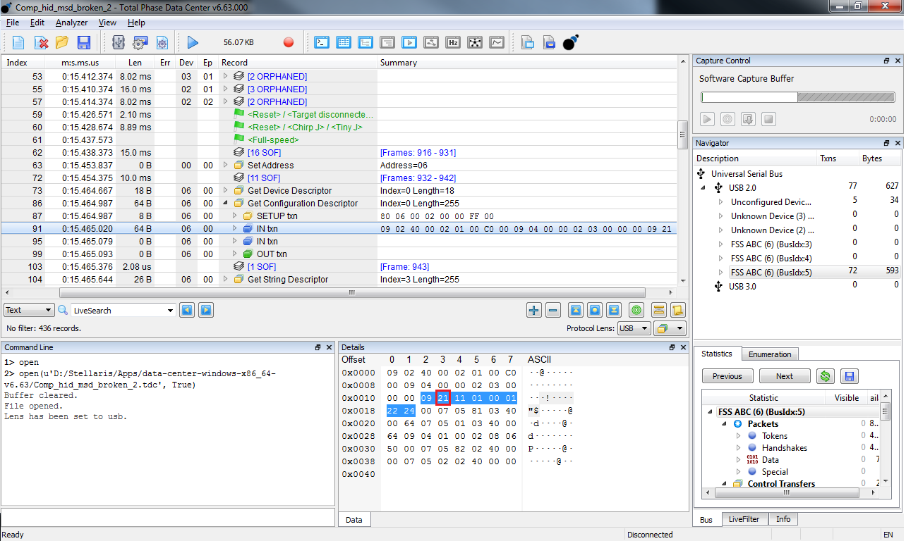

    What is the HID device? A mouse or keyboard? And what must I have in set up to see the two working?
    Amit
  • Amit,
    The HID is a custom one - neither mouse nor keyboard. It just shows as a HID_compliant device in Device Manager under HID. When the mass storage is enumerated, windows will recognize a mass storage device under Disk Drive. Windows will also give a pop up saying unformatted media found because the driver is sending zeros when Windows tries to read the FAT table. Right now, a USB mass storage device shows up in device manager but has the yellow caution triangle with the exclamation point indication it does not fully recognize the mass storage device.
    Yan
  • Hello Yan,
    It seems to be a device driver issue. Can you run USB trace using "Ellisys USB Analysis Software" to capture traces to see if enumeration is working correctly, or there is an issue during the enumeration which causes the PC host to not recognize the device.
    Amit
  • Amit,
    I was under the impression that HID and Mass storage does not require drivers. I will send pm with Total Phase Beagle capture files (data-center-windows-x86_64-v6.61_1 can be used to view these files). One for HID only under composite, one for Mass storage only under composite, and one for combined HID and mass storage. I can't figure out how to attach on a reply.
    Yan
  • Hello Yan
    When replying to the post click on the bottom right "Use rich formatting" and then you will come to a page where you can attach files.
    Amit
  • Amit,
    Thank you. Here they are. I had to rename the extension from .tdc to .txt else the system would not allow me to attach.

  • Hello Yan,
    All 3 files are composite devices or only the first one is composite device, with the other 2 single device files for HID and MSD?
    Amit
  • All three are composites. Composites have 0xEF as the Device Class in the Device descriptor.
  • Hello Yan
    Could you pleas describe what is that I should expect in each of the files?
    Amit
  • Hi Amit,
    After uninstalling the device and re-running the program, I was able to get further.
    Comp_hid_msd_broken2.txt - In this log, the host sends commands to fetch the Device descriptor, String Descriptor, and Configuration descriptor.  Report descriptor is fetched and eventually, the HID device is recognized.  However, the MSD stops after the MAX LUN message is exchanged.
    Comp_HID2.txt - In this log, the host sends commands to fetch the Device descriptor, String Descriptor, and Configuration descriptor.   Then the Set Idle and Get Report Descriptors are fetched.  HID device appears in Device Manager and the device is suspended due to inactivity.
    Composite_MSD_3.txt - In this log, the host sends commands to fetch the Device descriptor, String Descriptor, and Configuration descriptor.   The host recognizes the device as MSD and sends Get Max LUN, Inquiry, and Read Format Capacities ...

    Composite_MSD_3.txt
  • Hello Yan,
    In the broken tdc file, during the first "Get Configuration Descriptor" it sends 09-21- (as shown in the image below). There is no bDescriptorType with value 21. That is where the issue may be starting and you need to look into the Descriptor to see what is incorrect.
    Amit

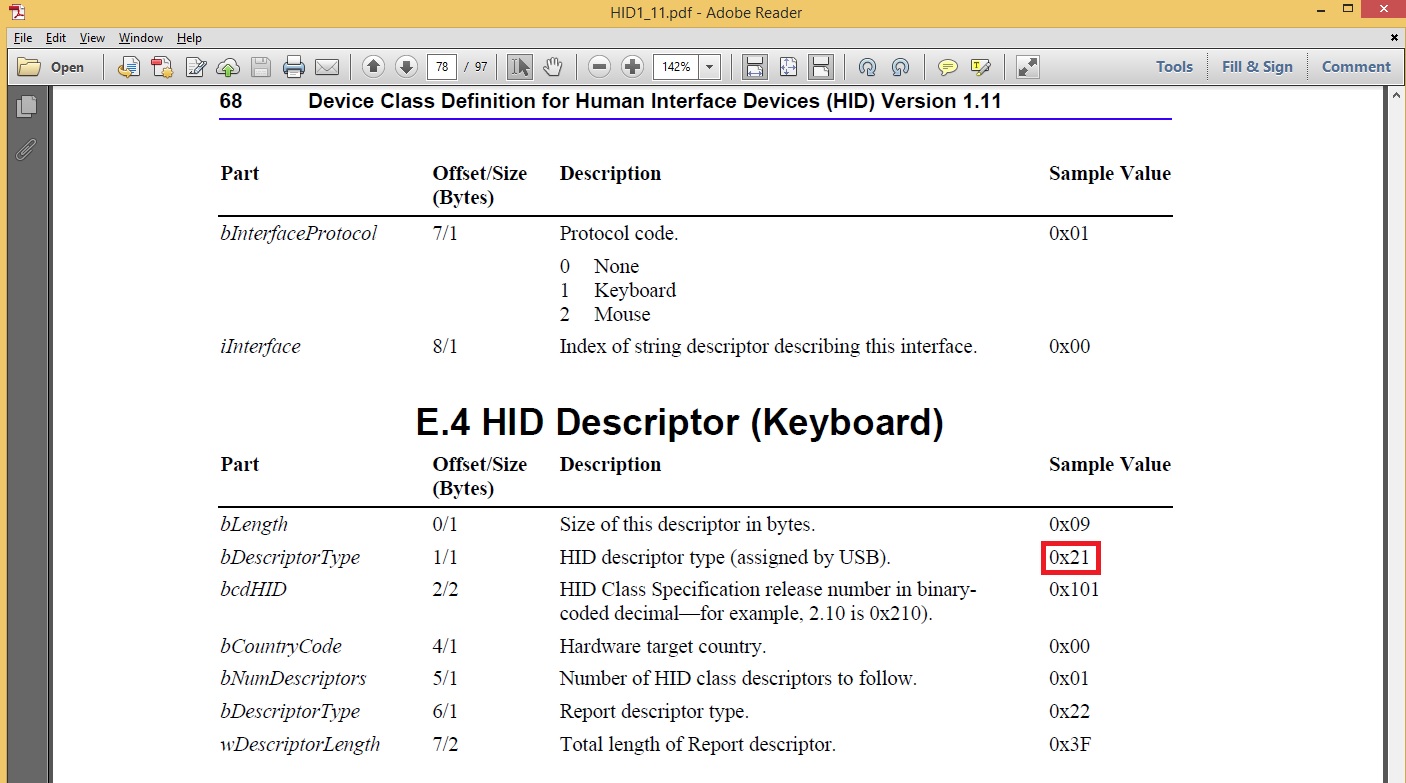

  • Amit,
    0x21 is the Descriptor type for HID. See The HID log file.  I have also inserted excerpt from HID spec:
