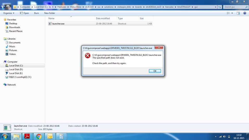

One of my customer is working on DRV8301-LS12-KIT. They have installed CCS software available in CD supplied along with kit.
when they connect DRV8301-LS12-KIT to PC, board is not getting connected to PC , I believe some drivers are not installed properly.
please advise how to resolve the issue. Attached is the screenshot of error, look forward for your valuable help, thanks.

  • Sorry for the delay in replying as I was out of office. You need to copy the contents of the C:\ti\Hercules\MotorWare\v1.0.3.03\sw\solutions\foc_encoder_speed\gui\guicomposer\webapps\ folder to the C:\ti\guicomposer\webapps\ folder.
    Then execute the launcher.exe from the right folder under C:\ti\guicomposer\webapps\.
  • Dear SIr,
    sorry for delay in reply. yes it is working and customer able to connect board to GUI, thanks for support.
