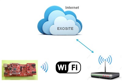

Sharing: Write and Read data to Exosite Cloud using Tiva Connected Launchpad + CC3100 BP + Sensor Hub BP
Other Parts Discussed in Thread: TMP006, CC3100, ENERGIA
Connects to AP through WiFi. I will update this post with blog post and link to github.
Features : Write and read data to Exosite.
               Sends Temperature data from TMP006 sensor to Exosite Cloud
               Sends switch press count to Exosite Cloud
               on-board led on-off, from Exosite Dashboard Switches
- kel

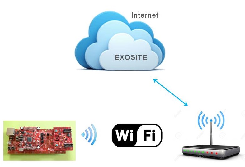

    I do not think Exosite Engineers misguided me. I have explained above about the details. I have seen projects in the internet, that uses hard-coded CIK in their program. So, I think hard-coded CIK is okay for project purposes only. Here is my conversation below with Patrick of Exosite for clarity.
    Tiva Connected Launchpad + TI CC3100 Booster Pack Exosite
    Regarding the long hours test, I am just merging the 2 working CCS projects below. If I don't encounter any problems doing that I will start the long hours test afterwards. I will just target 3-4 days testing.
    1. Elapsed Time incremented by 1 second timer interrupt and stored at a char array in this format "days : hours : minutes : seconds".
    2. Send email using Tiva Connected Launchpad + TI SimpleLink WiFi CC3100 Booster Pack.
    Note: After, I merge the 2 working CCS Project above, I will merge that CCS project to the program for this project.
    - kel
