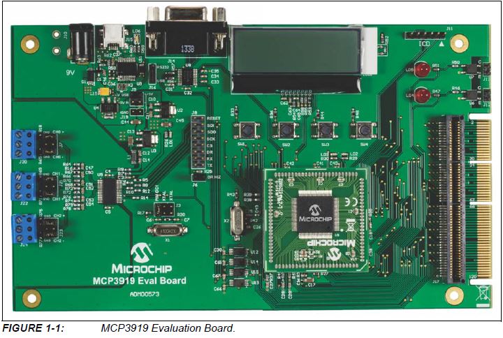

  • I've downloaded & read the ADC's data as well as the "formal eval board data" - for your MCP3919 device.   Earlier I asked if yours was a "home made" or "pro/factory board."   You indicated it was a, "pro."   Below are scans from the pro board's manual - is this (identical) "two board combination" exactly what you have - and have been using?   (this is very important...)
    In addition - here's the hook-up info:
    Now if this Figure 2-1 agrees with what you have - won't you experience "contention" between your TM4C MCU and the ADC vendor's MCU?  All here could be, "chasing their respective tails" if this proves the case.   If you do not believe that the ADC vendor's MCU directly connects to your ADC (as the above drawing reveals) kindly describe "HOW you've come to that conclusion."  (for example - how have you insured that (only) your TM4C MCU connects to the SPI, DR & Reset pins on the ADC?   Note that that fact has (never) been explained in your writings - and potentially may render all work done in your behalf - of little value...
    So complex a device - and so complex an issue (sporadic failure on power-up) - demands high & proper detail...

  • Ouch - your own board is scary. Even our (own) board is scary. (i.e. "any" first time board - at/around this level of complexity - is extremely suspect.)
    Board I've shown is 129 (USD) and should be, "bullet-proof." Firm/I always "recoil" at test/verify of user's new, "one and one only pcb!" Such boards (always) present, "Maximum Randomness" - any and everything is suspect.
    From the several hours I've spent in reviewing the ADC's 88 page manual (it is quite a nice part - BTW) it's Reset pin "toggle" should cause it to behave "exactly" as a POR. You must insure that your SPI signals, & DR, are proper (inactive) during your (ordered, non POR) Reset of the ADC.
    Then - and only then (after the ADC has emerged from Reset - should you start your MCU to ADC transaction flow.
    As we're at some distance - w/out seeing clear scope captures of Reset, each SPI line and DR - the identification & correction of your "intermittent POR issue" is unlikely to be solved quickly nor efficiently.
    If it were me - I'd invest in that vendor's Eval Board - which is "known good." Much as you (and ALL of my firm's clients) "believe" and "WANT" their self-designed board to be, "perfect" - that proves (rarely) the case - and my firm invests hours to find & fix.
    Scope caps - just as listed - really are required.   And your acquisition of the factory Eval board eliminates board execution as an issue.   Your "saving" of the "pro" board's cost flows down to your helpers here - does it not?   (i.e. "You" save at the time/effort expense of the helpers...)
