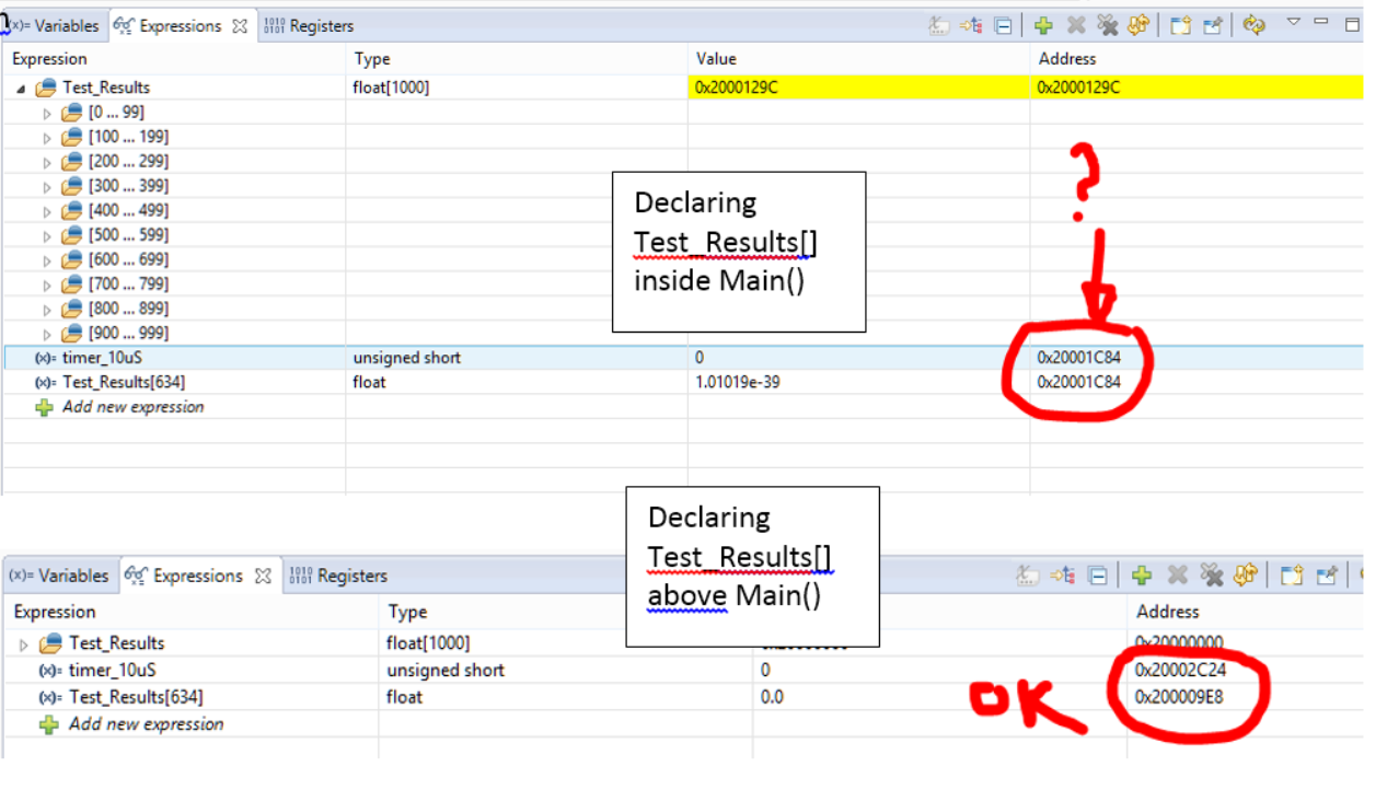

Using a TM4C1231H6PZI and CCS ver 6.1.0.00104 with Tivaware 2.1.1.71
I just discovered problem where the compiler is mapping a variable into another variable!  There are no warnings or errors from the compiler that this was happening and it took me 2 days to figure it out was going on!
When I declare the big float array Test_Results[]  inside the main, it puts the address of another global variable, timer_10uS into element 634 of Test_Results.
When I move the declaration of Test_Results[] outside of main, everything is fine.  timer_10uS is always declared outside of main.
What is going on?  Why doesn't the compiler/linker tell me somethings wrong?  Can I trust this compiler anymore?????????
See Screenshot......

  • Yes that's what I was talking about. it was just for a temporary quick test to gather some data to paste into a spreadsheet.
    It still does it when the array is smaller 300 or so elements.
    Well now I know to not declare huge arrays or too many variables inside a function.
    In any case, shouldn't I get a message or warning from somewhere that there is a problem?
  • There will be no warning when you fill up the stack, at least I think so.
    This problem seems weird since it happens when the array is smaller than 300 elements. But I will leave that warning - the stack standard value usually is pretty small (512bytes I think). If you really need that much elements in a array increase the stack a bit, you should have RAM to spare for that
  • I guess I should have declared it as static and it would work.
    Are you able to provide a complete CCS project which demonstrates the problem, since the that will probably be required to investigate the problem.
    Also, which version of the TI ARM compiler are you using?
