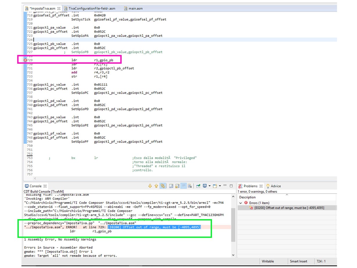

Strange "[E0200] Offset out of range, must be [-4095,4095]" error, how fix it?
Other Parts Discussed in Thread: TM4C123GH6PM
Hi all,
Recently I started to develop a little source for the TivaC Series launchpad (TM4C123GH6PM), but I'm coding in assembly language using Code Composer Studio v6.1.
I want to initializate all the internal registers of the MCU itself, but seems that I can't, because after a certain sets of lines, the compilers fires this strange error:
"[E0200] Offset out of range, must be [-4095,4095]" .
Tried many workaround to fix this error, but it still persist.
Seems that after have coded many lines, my macros stops working, and I don't know why.
Could it be some problem with program counter or similar that after many lines fires up an overflow and the compiler return this error?
Here I link all my code and hope in help, because I don't know what think anymore.
    The ARM documentation for the LDR, PC-relative instruction confirms that the instruction encoding allows for a maximum offset of +/- 4095 between the current PC and the address of the label.
    I haven't calculated the size of your assembler code, but believe the assembler error occurs because the absolute address offset between the ldr r1, gpio_pb instruction and the gpio_pb label exeeds 4095. To remove the error, believe you need to rearrange the layout of the assembly source code so that the labels are with +/-4095 of the instructions which reference the labels.
    A lot of work - you must know CCS support #include my_file.h, so you can save your work using any *.h files from driverlib (download it and use it if not yet...). Also, for "ldr" instruction, CCS need some special treatment/syntax in .asm, as described in this link.
    But best is to use the templates/examples from driverlib, written in C. Note Cortex-Mx micros were developed with goal(s) to write all programs (or most part of them) directly in C. No need to .asm; at least only critical routines/functions may be written in .asm.
  • Hello Lenoardo,
    Please post your ASM code and mark the line which causes the issue.
    Amit

  • Happy new year to Amit and all,
     I think this might be down to either a non-existant Literal pool, or one that is out of the 4K range. Chester mentions moving the code about, which would do it, when you discover the right combination. But if you add to the code the problem may re-appear. There's an easier way to do it with the code as-is, by forcing the generation of Literal pools when you need them. This is done with LTORG directive.
    If it is a literal pool problem then, as Chester mentions, the 4K addressing limit of some instructions is being exceeded, and like the OP says, you keep coding and after a while you overrun the 4K limit and things don't work anymore. Forcing the pool/s generation in the middle of the code cures this.
    What I can't tell you Leonardo is exactly how to experiment in CCS as I don't use it. It doesn't support all of the pseudo assembler mnemonics like MOV32 which are very handy and make for more readable code. If you're coding in C I'm surprised the IDE doesn't do this for you, maybe it's thrown by the extensive use of the macros?
    In IAR to overcome this, and there maybe a better way of doing it, at the end of each subroutine I put:
    LTORG
    as the bottom line and the assembler can use it if it wants to. This creates a pool for use at that position.
    Also, if you write your assembler with labels that are identical to the datasheet, then the assembler becomes much easier to read. The assembler also becomes portable, so for where you have multiple modules a routine is very easily used and converted. The entire device is constructed, and the datasheet is written, in terms of offsets, ARM assembler handles offsets beautifully, so for ease of coding look at using them. So, for instance:

  • Thank you so much Chester your reply help me so much !! You pointed me to the correct fix, and now I fixed all my project, I made huge modifications to all the project and now it goes without problem.
    I separated in many smaller files and now compiles.
    I had just attached in this reply the project if you want to check or just have a look you're welcome !!
    But, unfortunately I'm still unable to program my launchpad and I still don't understand why.
    In the project I just attached here, in the folder "Release" there is a file whose extension is ".out", but I think to need a ".bin" one to program my launchpad with the LM Flash programmer, can you still help me?
    To create a .bin file for the program add the following command under the CCS Project Properties -> Build -> Steps -> Post-Build Steps:
    "${CCE_INSTALL_ROOT}/utils/tiobj2bin/tiobj2bin" "${BuildArtifactFileName}" "${BuildArtifactFileBaseName}.bin"
    I just copied this post-build command from one of the TivaWare examples which creates a .bin file.
    Note that after adding a post-build rule to an existing compiled project, you need to perform a project re-build to force the post-build rule to execute for the first time, on subsequent builds the post-build rule will be run automatically.
    but I'm not able to program it, and I don't undestand why.
    The .bin file is necessary when using LM Flash Programmer. Since you have a CCS project, a possible alternative is to just start a debugging session in CCS. Starting a debug session causes CCS to program the .out file into flash and start the program running. i.e. starting a debug session avoids the need to create a .bin file.
