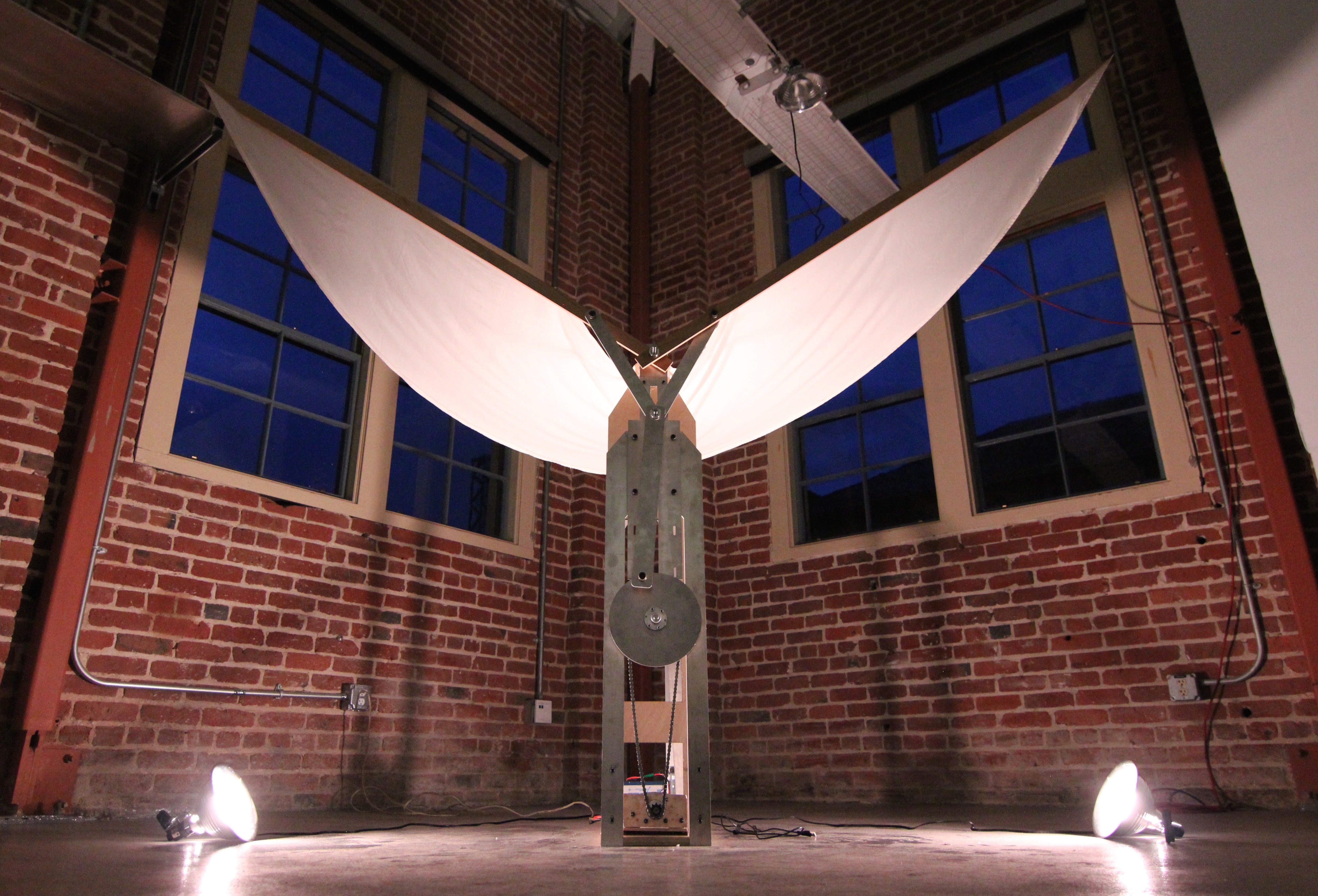

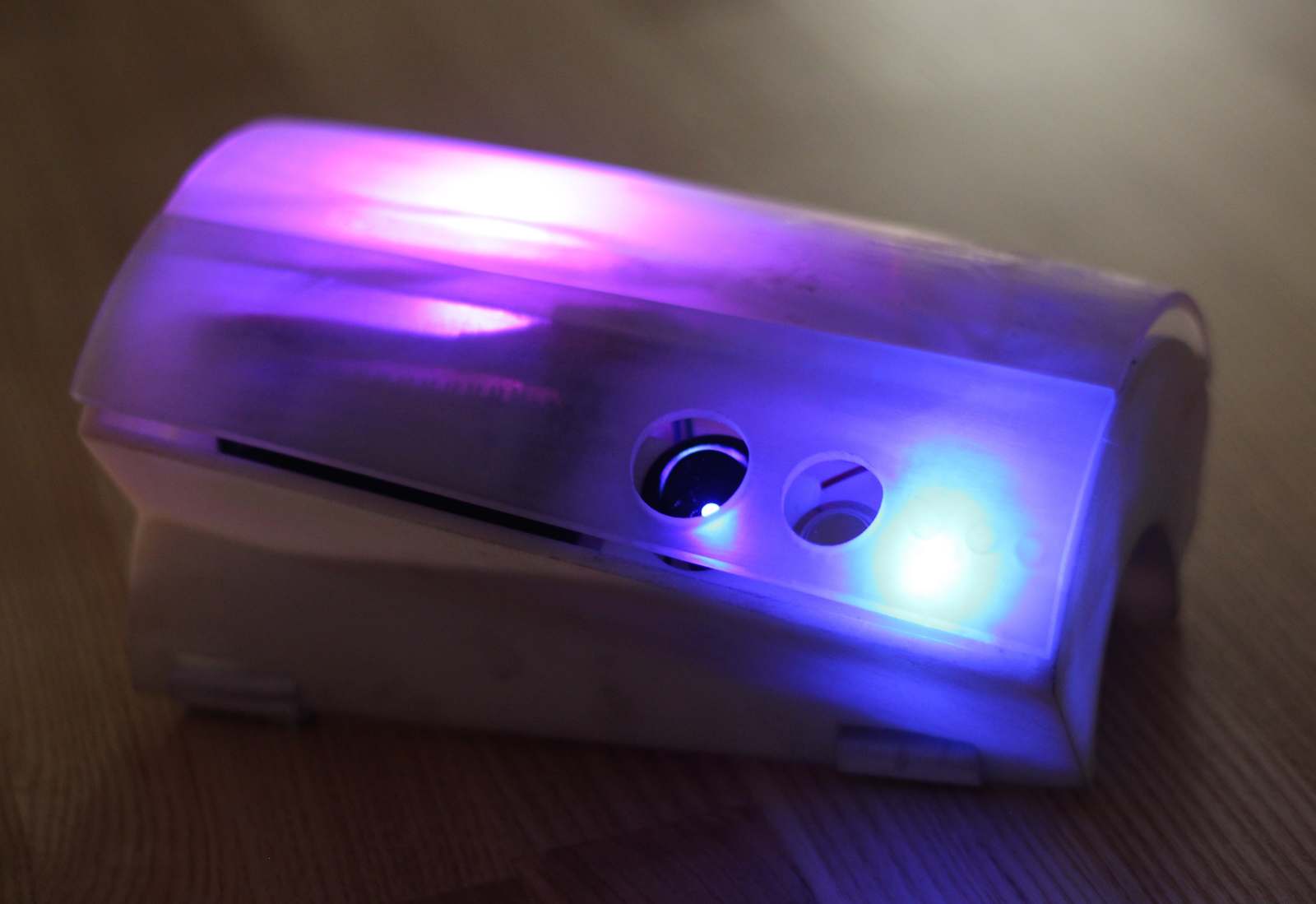

I've posted on this forum pretty frequently over the last six months. I've asked and gotten help on UART and interrupts, ports and GPIO pins (hint: they're probably locked, don't use C0), I2C communication, current output, the list goes on and on. All of it was for an ambitious project at Stanford that I successfully pulled off a couple weeks ago. This project was an exhibit at an event called "Personal Statements", a yearly design showcase put on by the Stanford Graduate Design Program. I just wanted to drop in, leave a few pictures, and say thank you. I couldn't have done it without your guys help. Thanks to everyone who helped answer my questions, and the MVP award goes to Amit for staying patient with my many queries. Thanks again!
"Flight: Gestural Control of a Kinetic Sculpture"
- The Wearable Control Vambrace.
- Flight, the Kinetic Sculpture.
Plenty more information, pictures, and video at my portfolio. You guys take care.

  • Let this reporter also, "Applaud the spectacle" - yet several note that those Leds (could) be brighter...

    I was reading your portfolio and noticed you had problems with the motor rpm and inserted a gear box. Looking at it run, have you tried removing the gear box and then changing the white cog for something bigger (ie making the white cog diameter bigger than the diameter of the crank pivot it drives) and lengthening the chain? It will run smoother. Converting to higher torque early on in such a system stresses it more.

  • Hi Pete - good thoughts but unfortunately this wouldn't have worked for me. I needed every drop of torque I could squeeze out of that motor, and the gearbox was doing the majority of the work. It added a gear ratio of 7. I maximized the white sprocket on the drive shaft and minimized the metal sprocket attached to the gearbox output shaft in order to get the highest gear ratio I could out of my chain drive, and that was only 4.5. The white cog/sprocket was already 6" diameter and the largest one I could get from McMaster for a drive shaft of that size.

    I would have thought as to how TM4C is used in the "Vambrace"
    Amit
  • I don't quite understand. You would like, in the Vambrace section of my webpage, for me to elaborate on how the tiva launchpad is being used?
  • Hello Zero_PD
    Yes, and what it does with the different movements initiated by the user
