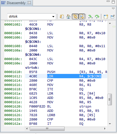

Looking into the disassembly code, there is an LDR call pointing to a protected memory area (I put a breakpoint before the FlashProtectSet() call in order to see the disassembly, that's why is visible in the image).

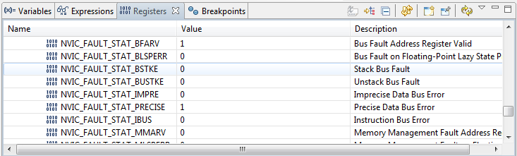

Going deeper, the FaulStat shows a BusFault precise fault, and the FaultAddress is shown in the image.
The disassembly at the Fault Address shows this:
As you can see, the LDR instruction points to $C$CON1.
Now the question is: how Can I fix this issue? I'm missing something here?
