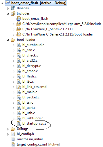

I am into developing an flash boot loader for TM4129NCZAD based custom board. While walking through the flash boot loader demo project, i am not able to find the file "bl_startup_ccs.s" in the CCS when I open the project. I am able to see the file "bl_startup_ccs.s" in the file manager.
I am attaching the screen shot

    I imported the project from the resource explorer.  I am also seeing the startup_ccs.c file.  I am not able to see the "bl_startup_ccs.s" which contains the SVC handler  " (*((void (*)(void))(*(unsigned long *)0x2c)))()".

    I was under the impression that you wanted to import the "boot_demo_flash" project. Your original post says "Flash bootloader demo" project. Are you trying to import the  "boot_demo_flash" or the bootloader itself?
    If you are importing the "boot_demo_flash" project then "bl_startup_ccs.s" is not required.
    "bl_startup_ccs.s" file is required by the bootloader. I imported the project "boot_emac_flash" from the dk-tm4c129x board into CCS and can see the "bl_startup_ccs.s" file. Please see the screen shot below.
    Please use the menu options "Project->Import CCS Projects..." to import projects into CCS. Desktop and CCS versions of Resource Explorer is not fully supported with TivaWare.
