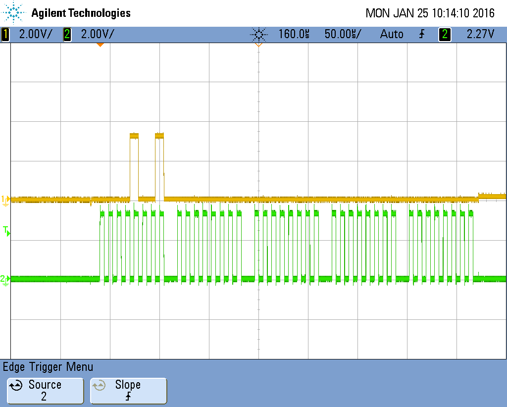

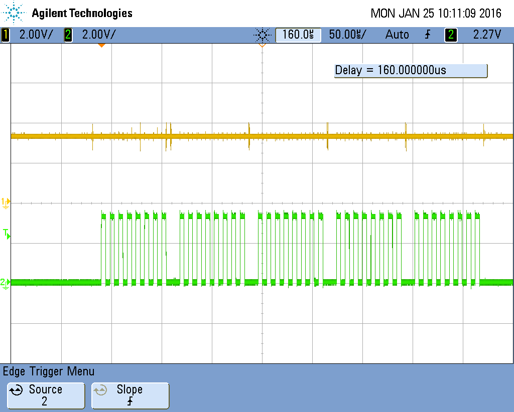

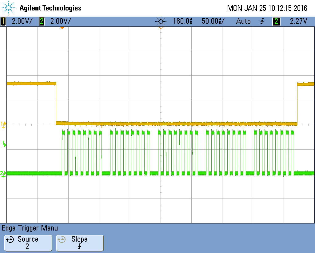

    EDIT: I tested and confirmed tested the following things:
    No common connections exist between the two SPI devices; one device at a time is tested.
    ~CS pad is really driven LOW, both with device #2 (or #1) connected to the SPI bus and with no device attached to it:
    MOSI pad stays HIGH when SPI device #2 is connected;
    the same pad shows the data sent to the SPI bus when nothing is connected to it.
    Data read from the device are 0xFF, according to both the debugger and the USB monitor software I am using. MISO and MOSI pads are not shorted.

    Let me add more on this from yesterday's efforts: I noticed that when I touched the MISO pad/line (bare wire that is soldered on the perf board) the state of the line changed from HIGH to LOW; the data I was reading changed from 0xFF to 0x00. Taking my hand away resulted in the previous situation (MISO to HIGH and data to 0xFF). This shows that somewhere, something is not properly connected - either a ground return or a cold joint on the MISO line or I don;t know what... All this happened just before ending the previous day, so I have not proceeded with any corrective action yet. And the bad news is that, after trying to add some ground wires around and under the SPI lines on the perf board, neither device #2 nor device #1 work; all I get is MISO at HIGH and corresponding data of 0xFF... The first thing to do when I get back is to rebuild the interface in a better way.

  • Hi to all, I am back to work and have come to a solution that has to do with wiring!.. I feel really ashamed for not having noticed that earlier, for it would have saved me much time and effort - and I would not have to bother you, too...
    Here is how it goes:
    The cable where I connect the DUT ends to a female connector (2 x 8, 1.27 mm pitch).
    Device #1 sits on a test PCB that has a female connector (2 x 8, 1.27 mm pitch).
    Device #2 sits on the same kind of test PCB that has a MALE connector (2 x 8, 1.27 mm pitch).
    This means that, in order to connect device #1 to my cable connector, I have to reverse the position of the two pin rows by means of a proper custom-made (by myself, of course) male-to-male adapter; to connect device #2, this reversal SHOULD NOT be done!
    That's why I kept having MOSI at HIGH and so on... signals did not even reach the DUT in the first place! :(
    After a lot of head scratching in front of the logic analyzer, I picked up the DMM and soon I came up with the solution.
