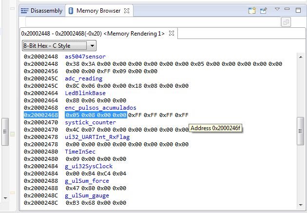

On a TM4C123 project using CCS, there a variable that appears to be "corrupted" somewhere else. Details:
- It is a public variable declared on the main_project.c: int64_t enc_pulsos_acumulados;
- It's value is only changed in one and only one location. It is behaving as expected, accumulating "small values" such as 805, 806... Suddenly, the high bits of this int64 all become FF FF FF FF...
- I added a couple of tests before and after the only location where it is changed, and it shows that actually this corruption comes "somewhere else". Piece of code posted below (pasted as an image just to better illustrate where the breakpoint stoped.
I also looked at the memory location to check if eventually there was an array or something nearby, but it does not seem to be the case (image below).
I tripled checked and there is no other attribution to this variable elsewhere.
Any suggestions as how to debug and find what's happening?
Thanks!!!
  • I've quick/dirty comment:
    • those high bits all @ "FF" have the scent of "subtraction beyond zero" - rather than "accumulation!"   Is that possible?
    • suspect that (some) signal is being injected - and being accumulated.   What happens when you more precisely control this signal?   Is it (even remotely) possible that your signal input becomes, "out of spec" and/or "floats" - which may account for so drastic an "accumulation?"   I'm suggesting that you "feed your input" with a very controllable - and known - and proper (voltage & rise/fall times) signal - and then test/observe that.
    • Pro IDEs (Keil, IAR) enable you to "watch" a selected variable - capture & chart each/every variable access
    • I note that you test - via, "pulsos_absurda" (past had "friend" w/that name) for such "illegal" activity.   I'd do precisely the same - but (now) via far more controlled inputs.
    • you don't state the number of boards which "repeat" this behavior.   Single board anomaly drives guys like me Krazy!
    • might RF or high currents be the cause?   How have you checked?

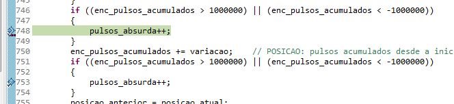

  • Thanks for the comments. It's not hard to solve it another way (eventually it will magically get solved when I detach this function from the main file into an external library, and replace direct variables by pointers), but I don't like to waste the opportunity of learning. At least we might come up with a check list of ideas for such cases:
    - Single-step and watch the variable. Not too good for this particular case where we read a sensor at ~400Hz and the error happens randomly, but likely to be the first debug tatic.
    - Checking for DMA's (this project does not use them, however)
    - Log every change of the affected value (does CCS allow for that? - this one I never used... I even found some sort of breakpoint whose name suggests that's what it does, but I did not go ahead on that path so far).
    - Add error counters when the involved variables cross some limits (this was done for current debug, and interesting enough, none of the variables before the problematic one ever crossed their lines!) - so not only CB's friend pulsos_aburda (was he Latim?), but also threshold-shields for all of his other friends.
    There are check-shields both after and before the line where bad-variable gets modified, and the breakpoint flags always before - meaning that the dirt hit the fan outside the function... And here's the checklist I used to verify nothing can change it elsewhere:
    - Obvious F3 search for the variable name in all files of the project
    - Looked for memcpy or any other direct memory modifier
    - Verified the memory location and inspected the neighbors, in case there were any arrays nearby accidently overwelcoming their declared size.
    Again it was not the case, but at least the post might come in handy for others in the future.

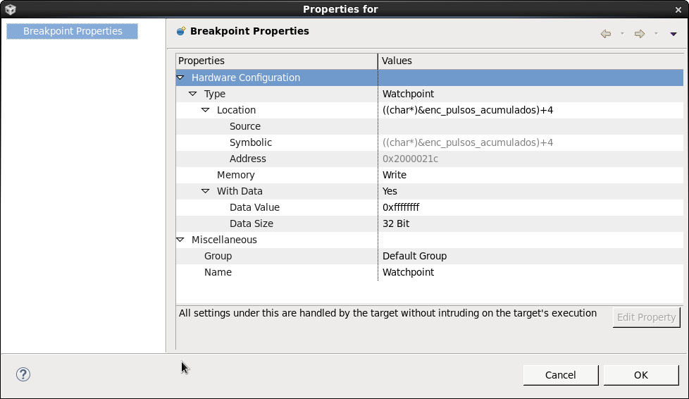

    Since the corruption occurs when the 32 most significant bits get set to all ones try setting a Hardware Watchpoint in the CCS debugger with the following settings:
    [When a Hardware Watchpoint is created, the "With Data" property is No by default, so you have to right-click on the watchpoint in the Breakpoints view and change the Watchpoint properties to select "With Data" as Yes and set the data value to stop on. By setting "With Data" to yes the watchpoint will only trigger when the corrupted data is written]
    That will trigger a breakpoint when the CPU sets the most significant bits of enc_pulsos_acumulados to all ones. On the assumption that the corruption is coming from a CPU write, that should identify where in the software the write is coming from. Note that the breakpoint might trigger several instructions after the actual write, so once has halted the Program Counter shown in the debugger might have advanced a few instruction on from the actual instruction which wrote the "corrupted" value.
    24/2/2016 14:44: Edited to show the correct way of specifying the upper 32-bits of a 64-bit variable.

  • But the corrupted variable (if interpreting the image in the first post correctly) is declared as "static", and as such lives with the global variables, and not on the stack.
  • Robert Adsett72 said:
    Speaking of which, I don't see where you're modifying the variable in question. All of the variables you modify appear to have function scope.
    There is actually one global variable, which is exactly the one bugging me:
    g_encoder_accupulses += displacement_pulses;+= displacement_pulses;
    Purposedly, everything else indeed has function scope, and we don't have to worry about them outside. So the mistery remains: how can suddenly g_encoder_accupulses have a huge negative value? The threshold shield flags inside the function, before the modification (in other words, it leaves the function with a good value, and when the function is next called, the variable shows corrupted values, as if it had been modified somewhere else).
    The suggestions above are good for a general situation where one is trying to find where his own code destroys the variable. They don't seem to apply when the suspicion is memory corruption. I could log 1000 previous values inside a ring buffer, and all I would see it that this variable suddenly goes from an expected value into something like -4987654321000 with no apparent reason... :(
    As a matter of fact, the problem is in fact solved when I dettached the function from the main file to a separate library file. The variable is now passed to the function as a pointer, and it has not gotten corrupted for the past 40 hours of bench test... Everything else remains unchanged. The play here, again, seems to find out what makes a memory section suddenly become FF FF FF FF away from the C programming...

    The reason I suggested using a Hardware Watchpoint to try and trap the source of the memory becoming FF FF FF FF is that the Hardware Watchpoint makes use of the Cortex-M4 Data Watchpoint and Trace Unit (DWT) to watch CPU writes. i.e. is independent of the C code, and allows the program to run at full speed (in case the corruption is timing sensitive).
    Did you have a chance to try the Hardware Watchpoint. If so, did the Hardware Watchpoint trigger when the memory section became FF FF FF FF or not?
    That is to try and determine if the corruption comes from a CPU write or not. If it is coming from a CPU write the next step is to determine if the cause is a software error.
    Actually you need a slightly more sophisticated watchpoint.
    The watchpoint involves an address compare and a data compare, since watches for a specific data value being written to a specific variable address.
    I created the following test program:
     * main.c
    #include <stdint.h>
    #include <stdlib.h>
    static void generate_variable_corruption ()
        enc_pulsos_acumulados = -rand ();
    int main(void)
        uint64_t iterations = 0;
        for (;;)
            const int input = rand();
            if ((iterations >= (1 << 24)) && (input == 12345))
                generate_variable_corruption ();
            else
                enc_pulsos_acumulados = input;
                iterations++;
    	return 0;
    This test involves writing mainly positive values to a 64-bit variable, and after several million iterations writing a negative value.
    The test ran on an a EK-TM4C123GXL using the built-in Stellaris ICDI. CCS 6.1 was used to set the following hardware watchpoint which detects a write of FF FF FF FF to the most significant 32-bits of the 64-bit variable enc_pulsos_acumulados:
    The program was run, and the CCS Expressions view was set to display a continuous refresh of the enc_pulsos_acumulados variable which showed "good" positive sample values while the target was running for several 10s of seconds. The view when the watchpoint occurred was:
    This showed the watchpoint has triggered after the negative write to the enc_pulsos_acumulados variable. Note that the current Program Counter location is in main, since the program executed a few instructions after the write before the target halted.
    This demonstrates a watchpoint using an address and data compare without requiring an expensive emulator, as uses the built-in Cortex-M4 DWT.

    The ARM documentation for the DWT address comparison functions shows that a DWT Address Comparator can Generate Data trace PC value and data value packets on a write to a monitored address. In theory if those trace packets were routed though SWO the debugger in the host could interpret the PC values which are writing to the variable, and cause the target to halt once an out of range data value and/or incorrect PC value was seen. Of course, dependent upon the rate of writes to the variable some trace packets (and thus writes) might be missed.
    However, my attempt to set up such capability have so far failed:
    1) In CCS 6.1 using the SWO trace on an XDS110 I can get Data Variable Tracing to show the the variable address and data value, but can't see a CCS option to configure the PC value and data value.
    2) Using IAR 7.40 with a J-Link configured a Data Log to trace the PC value and data value for a write to a variable, but the trace log was empty. Not sure if this is a bug or I am not using the tool correctly.
