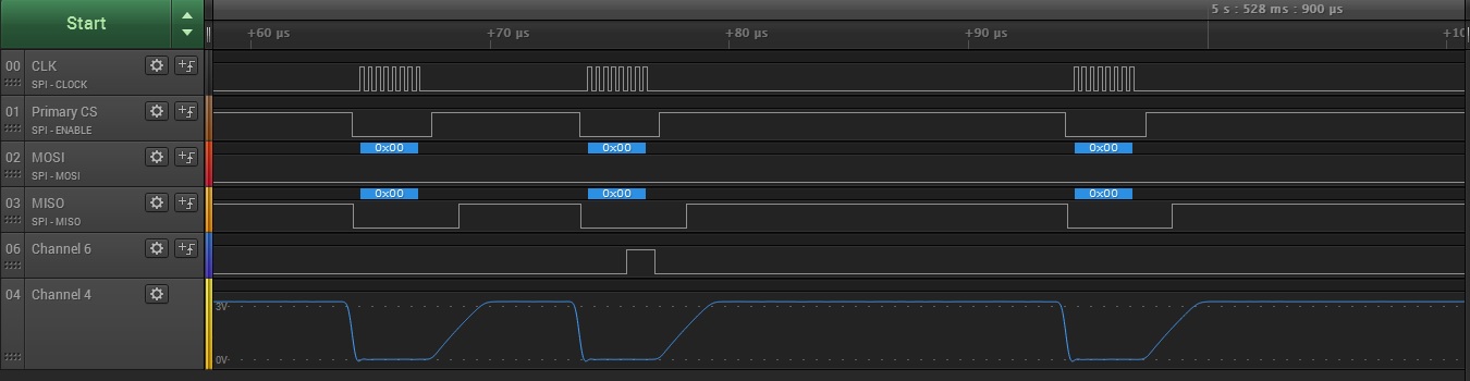

In my setup the host master device sends many SPI commands to the Tiva (especially on start-up).  Irregularly, the Tiva will reply with 0x0 when it should be replying with an ack (0xA5).   I have tried the following tests without correcting the issue:
1. I have scoped the MISO line when this issue occurs and have seen the line is active (pulled low) for the byte in question, but does not attempt to send an 0xA5 pattern.  This rules out the condition of another device dominating the MISO line.

    cb1: How do you know your TM4C is, "active & pulling down MISO?"
    In this capture, 04-Channel4 is the analog version of the 03-MISO line. The 06-Channel6 pulse is when I am attempting to write the 0xA5 ack byte to the tranmit buffer. I expect the next byte to go out the MISO line should be the 0xA5 (and usually it is).  In this affected example, it does not transmit on the next byte nor does it on subsequent bytes. I expect that if the Tiva was attempting to output 0xA5 on the MISO line, I would see some activity on 04-Channel4 corresponding to the 0xA5 bit pattern.  Because the pulling down and releasing of the 04-Channel4 MISO line is regular and consistent with all other MISO transmissions, I draw the conclusion that the Tiva is in control of the line and an external device is not dominating the line.

  • I thought I would post a follow-up with where we ended up with this issue.
    We were using a polling type communication scheme where the host would send a command to the Tiva and continually ping it with read commands until it received an answer. This had the negative effect of 1. depleting the Tiva's output FIFO 2. much overhead and bus traffic of dealing with all the read commands while the Tiva is trying to process the original command.
    While I have no conclusive proof, I suspect the missed ACK was a result of the depleted transmit FIFO. When the Tiva receives a SPI byte and has nothing readily queued in its output FIFO, it sends a previously sent value. We were not keeping the Tiva's transmit FIFO continuously populated and relying on this 'previously sent value' as a placeholder response to the host until the Tiva had an actual response to send. I believe there can be some undefined behavior related to this operation.
    We ended up re-architecting the host/Tiva communication protocol. The host now sends SPI commands/data in 4byte chunks (more in line with how the Tiva's SPI interrupt is triggered) and waits for the Tiva to interrupt back to the host to say it's done doing what it needs to do and has a response waiting. The host then sends down a read command to get the Tiva's reply. This eliminates the behavior of exhausting the Tiva's transmit FIFO as well as reduces the SPI traffic at the cost of added complexity around the added interrupt line to the host.
