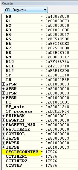

    Why "calculate" when a (real) PRO IDE (such as IAR, Keil) does exactly that?     With NO Effort nor code penalty being introduced!
    An independent (and automatic) MCU "Cycle Counter" as shown -- along w/SWD - and the ability to work w/ALL Vendors' MCUs - not just one - proves far superior...
    Here's IAR's instant & zero-effort, "solution" to your quest:  (available on the free, Kickstarter version):

    Segger looks like it may have a tool that does all of this as well but I've not had the opportunity to work with it yet.

    Cortex-Mx micros have a powerful mechanism implemented for such thing. Good to be used for functions, code in general - except for global time estimation in rtoses. (In IAR debugger is included by default).
