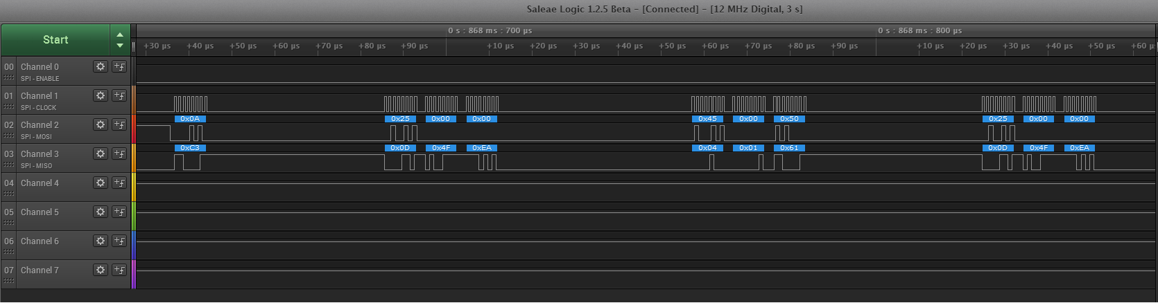

I would like to communicate with ADS1262 using SPI. The code that I am using successfully works with TM4C123GXL but fails with 129EXL. To make sure that the SPI wiring is OK, here is the screenshot of a communication trial.
As you can see only the MISO channel fails, I mean I dont have any reply back from the ADS. (Stop Conversion command, Read Register , Write register, Read Register the above sequence.)
Any idea how to go on? Tried on two 129EXL boards but failed.
Pinout configuration:
SPI CS: PD2 | SPI CLK: PD3 | SPI MOSI: PD1 | SPI MISO: PD0
PS.: I've also tried the SPI Looback TI RTOS SPI example and works flawlessly, the ADS works well with 123GXL.
  • Your chip select looks wrong, I would not expect it to be de asserted between bytes to the device. I suspect the device is restarting the command parsing on every new chip select assertion and never completing a command. Typically besides enabling serial I/O the chip select acts to synchronize the external device.
    Robert

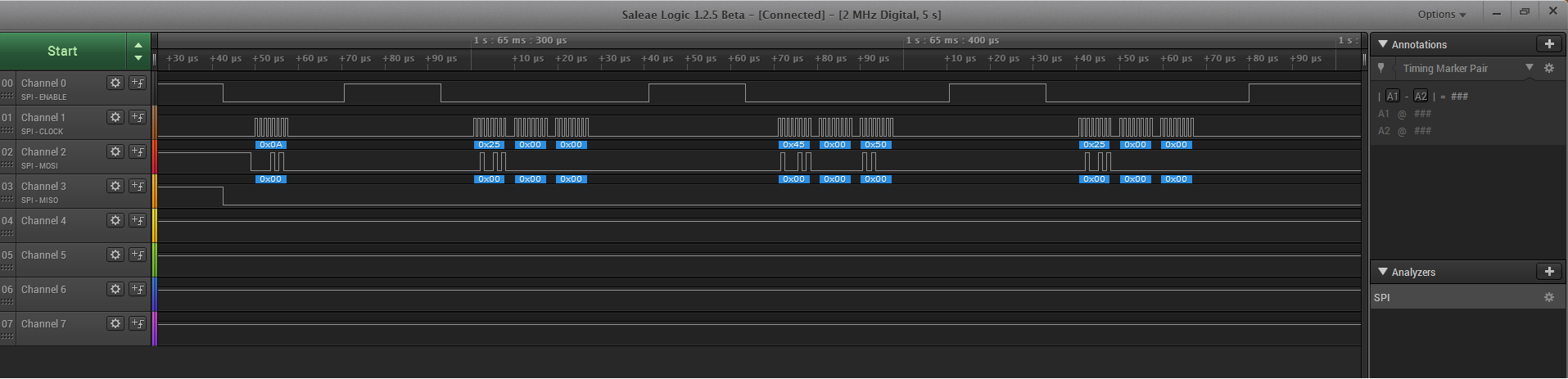

  • Dear Robert,
    Thank you for your reply. Regarding the chip select, it is controlled by RTOS. However I made some changes and CS is controlled by self. Here is the outcome:
    As you can see, the still dont have valid reply. (Interesting is the 123GXL uses the same CS timing and works fine.)
    I have disabled the CS control for every byte as you suggested. As you can see the reply is not what expected.
  • Did you capture the timing for the '123 case?
    The first plot looks correct to me now, the second looks wrong, I would not expect it to work either since you do not de-assert cs between transactions.
    Something is pulling MISO low, the first thing I would do is find out what. Isolate the MISO line so that the device and the micro are not connected and make sure both have pull-ups and see which pulls it low. The micro should stay high and the device send out its response.
    Robert

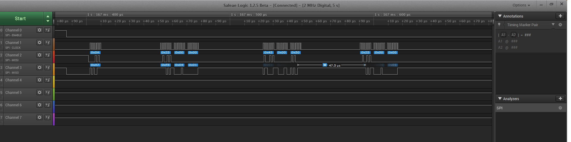

  • The most recent outcome, when MISO is disconnected from the uC. I expect that the last read should be equal to the previous write.
    I am working on the pullups.
  • The project that I've modified is TCP Echo example. Do you think that this project pinmux should affect on SPI? I have tested the ADS1263EVM with 129EXL but failed. I am going to modify the SPI loopback and coming back with the result.
  • If your latest snapshot was from the device output and the input to the micro was pulled low I'd say that was a reasonable possibility.
    Certainly something is driving the micro's pin in that case. Since it appears to be happening on multiple boards I'd not place pin damage as my first suspect, although a short on the board is a possibility.
    Robert
