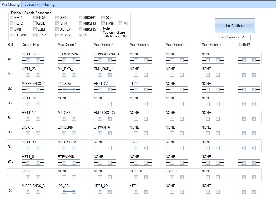

I'm using the I2C port of a TMS570LS1227 to read the values given by a sensor. First of all, to verify that the I2C works, I've configured it as a GIO using HAlCoGen, and it works fine!!

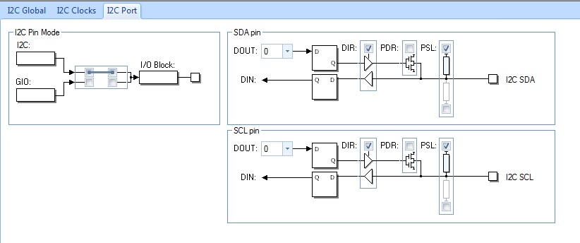

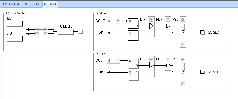

After this, I've configured it as a I2C, the configuration paramenters that I've used in my project are the following:
Besides, I used the example: example_i2cSlave_TX_RX.c to check if the comunication works, but there're no SDA and SCL signals! Regarding the hardware, everything looks ok, I've connected 10k pull-up resistors for the two lines, any idea about what's happening??
