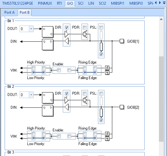

I was just doing the most simple example for an ADC on the Launchpad TMS570LS1224 but i couldn't make it work. I am using CCS 6.1.1 and HalCoGen 04.05.01.
The exmple is just meant to take data from an ADC and show it some LEDs.
The configuration on HalCogen is as follow:
And the code is as simple as this (in sys_main.c):

The thing is, i can't get a single value of the adc_data despite i change the voltage at the input. It even can´t get throught the while(adcIsConversionComplete(adcREG1, adcGROUP0)==0){}; (i know that because the first led is not on). For this simple example i looked at most of the registers but i can't make it work.

  • ADC group 0 is the name used for the "Event" group, which is a hardware event-triggered conversion group. The line in source code:
    adcStartConversion(adcREG1, adcGROUP0);
    sets up the channels selected for conversion in group0. The ADC is still waiting for the selected event to occur so that the group0 conversions can start. The default trigger event is a falling edge on the AD1EVT pin. You can even generate this falling edge by configuring the AD1EVT pin as an output pin and then driving it high followed by a low. This will start the conversions. Then you can poll for the conversion-complete flag to be set.
  • Alternatively, you can switch over to using group1 for the conversions. This group is software-triggered by default and the conversions can be started by calling adcStartConversion(adcREG1, adcGROUP1).

    Sunil you were right, the trigger event was what i forgot.
