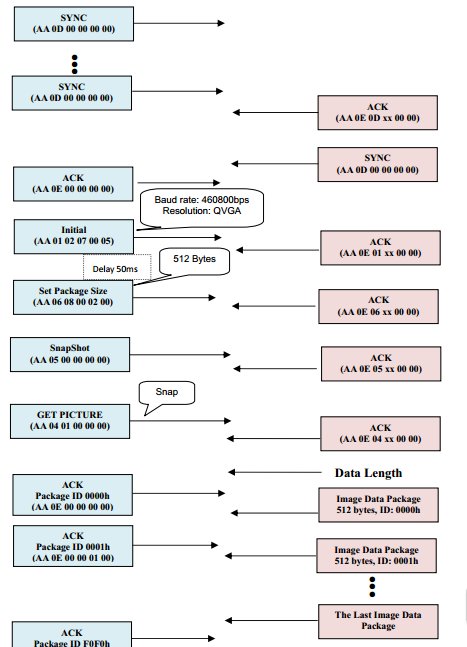

  • Hello Stellaris Sai
    I am working with the TM4C129 in order to use a camera, it is comunnicated by the UART, I have already established communication with it, but my problem is when the camera take a picture and send me the dates because everypicture has 512bytes but I only can receive 16bytes... Something tell me that I can´t receive the dates becuase the FIFO receive has 16x8 bytes then I have to use the modem flow control.
    What do you think abou this???
    thanks and excuse my inconvenencia

  • Hello Stelaris:
    First of all I am using the TM4C129NCPDT LaunchPad and I started work with CLP_Workbook so I did the examples like: Initialization, GPIO and TivaWare , PWM, SPI and QSSI and UARTas to the code, I do not use interruptions, only Iam working with polling, and I always only receive the first 16Bytes
    I send a picture which it shows how is the comunication

    Can you see in the picture, the protocol is easy, because I send comands and receive comands..
    Thanke you very much..........
  • Iam sorry, I sent my code................ I can not sent the picture
  • This is the protocol of Transmition
