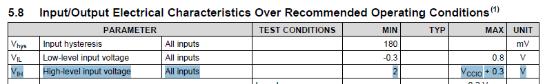

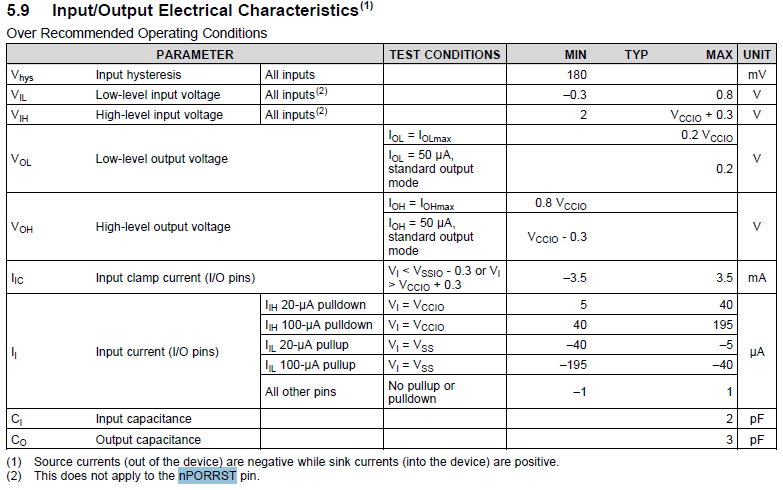

Dear e2e,
what is the min. specification for Vih for the nPORRST Pin or does the standard value of min. 2V applies here? While Chapter 6.2.3.1 lists the parameter for ViL for nPORRST, there is none for Vih. Note 2 implies that  Vih will be different for nPORRST.
Kind regards,
Uli
