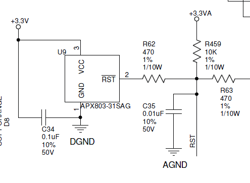

Reset Signal Sanity Check
Somehow we ended up routing the Reset input to VDDA and pulled done (via SVC) to GNDA.  Probably were mixing up power domain usage with the crystal power domain.
I any case we want to be sure that this is, in fact, wrong and that we didn't pick up on a reference from elsewhere before we go ahead and correct it.
