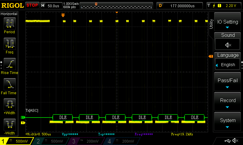

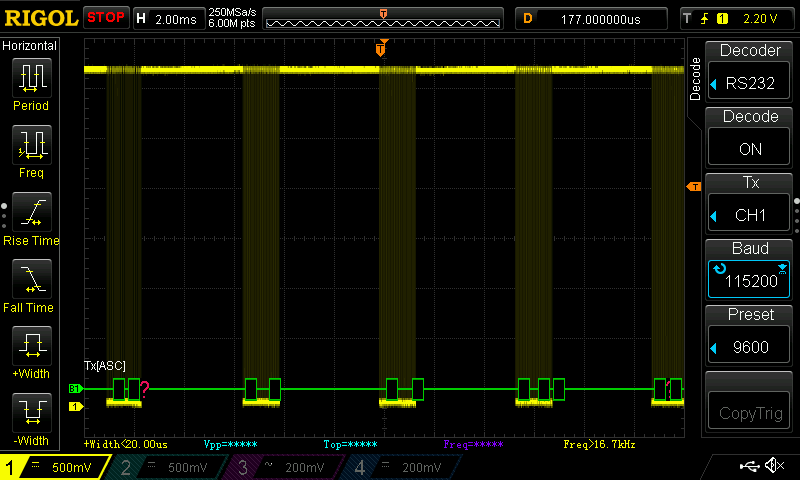

Hi all,
I'm trying to use uDMA to control UART6 data transmit and receive. Eventually, I plan to use UART4 as well in the same manner.
UART6 is configured as 115200 8N1 standard UART and I want to use the uDMA to transfer up to 128 bytes at a time without processor intervention.
I am using a TM4C123GH6PM on custom hardware.
This currently seems to initiate a transfer but the first byte is repeated 32 times, and sizes above 32 bytes just seem to be "clipped" so to speak. No bytes beyond 32 are ever transferred (I do not see start or stop bits in the UART waveform.)
Here is my code, some of which is based off the working example (udma_demo)

Oscilloscope screenshot showing repeated byte:
Waveform showing maximum packet size and lack of any transfer past 32 bytes or so:
