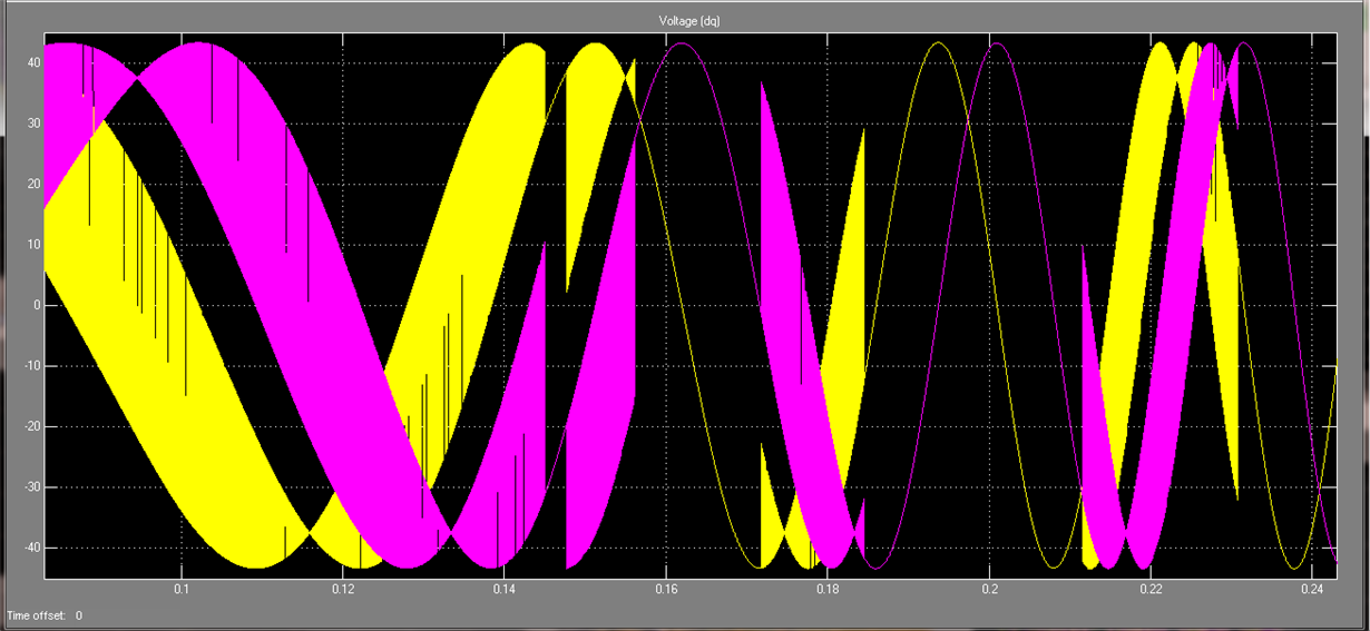

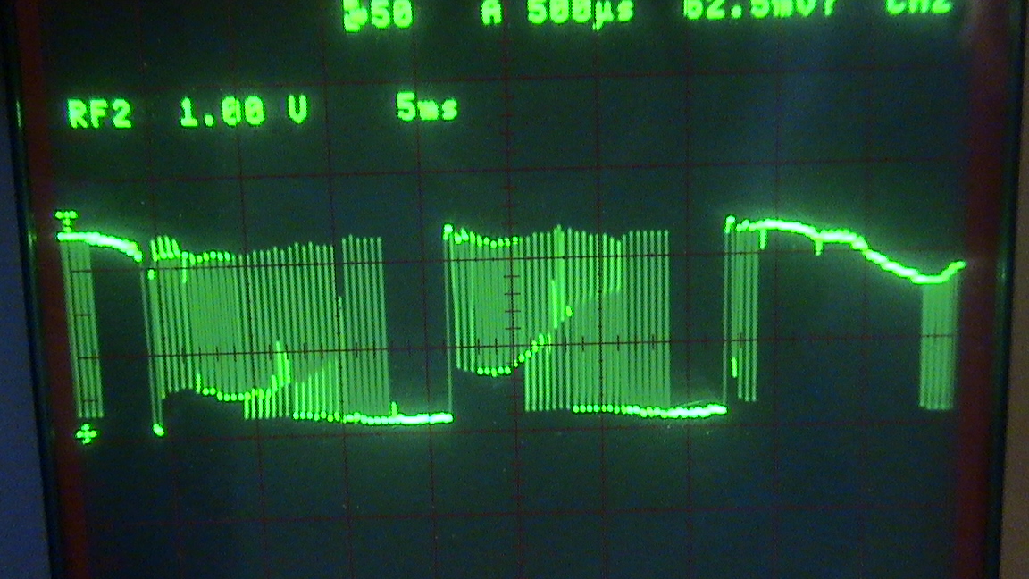

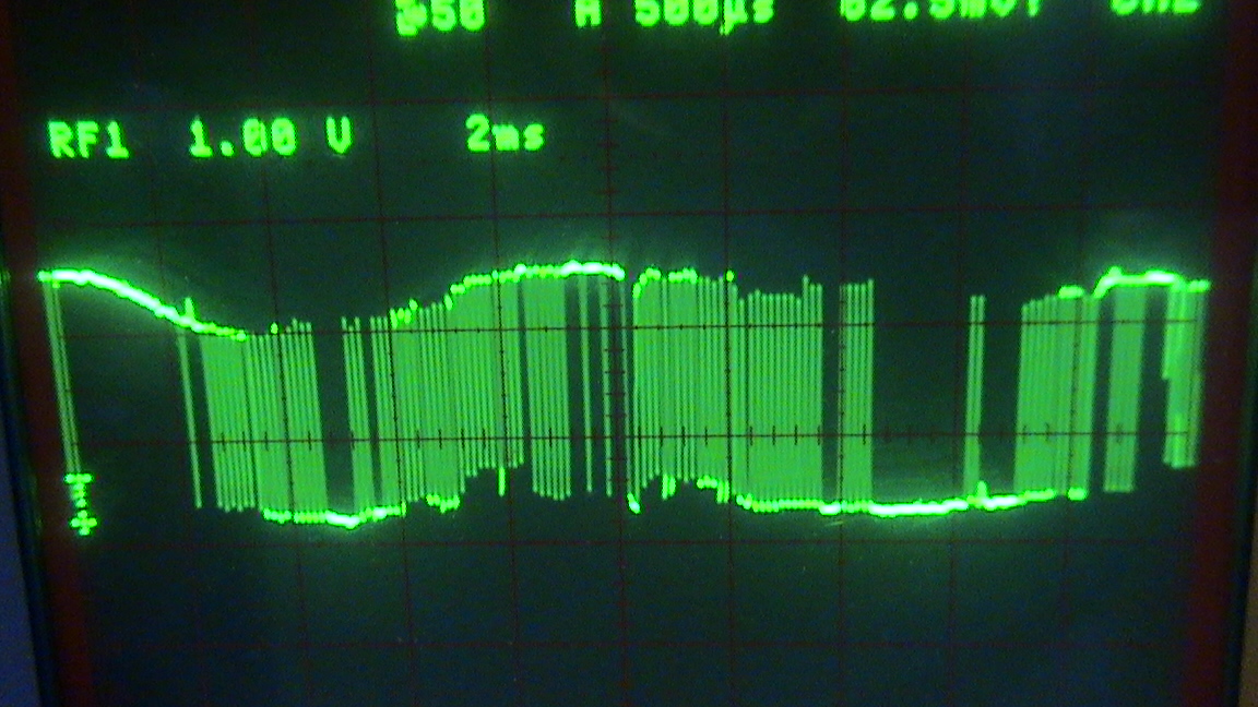

  • Case anyone was wondering - below shows a simulated PWM sine wave 2 axis (dq) in a 3 phase AC motor, wave appears very sinusoidal. The 2nd-3rd (qs-bldc) captured 20kHz and motor shaft speed roughly 10 RPM with 60Hz Hall code changes, 24vdc 200ma.
    25Khz PWM - rotor roughly 0-30 RPM
    20kHz PWM:
    Notice modulated flag sine wave center inverts, 12.5kHz PWM @60Hz Hall code changes.
