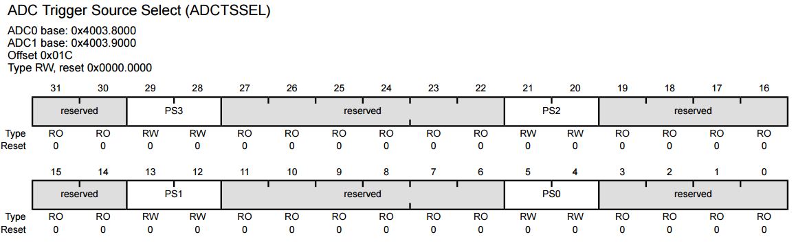

There appears to be an error in ADCSequenceConfigure() in the v2.1.2.111 with regard to the setting of ADCTSSEL which encodes the PWM Generator and Module with which to trigger the ADC.  You can demonstrate the error by setting a PWM trigger for PWM 1, Gen 2--the function will erroneously set PWM 1 and Gen 1.  The existing code uses the PWM module and ADC Sequence rather than the PWM Generator:
ui32SequenceNum *= 4;
// Set the source PWM module for this sequence's PWM triggers.
ui32SequenceNum *= 2;
HWREG(ui32Base + ADC_O_TSSEL) = ((HWREG(ui32Base + ADC_O_TSSEL) &
~(0x30 << ui32SequenceNum)) |
((ui32Trigger & 0x30) <<
ui32SequenceNum));

  • You can demonstrate the problem with the following code:
    ADCSequenceConfigure(ADC0_BASE, 1, ADC_TRIGGER_PWM_MOD1 | ADC_TRIGGER_PWM2, 0);
    This sets ADC_TSSEL to 0x00001000 which is in the reserved part of the register.
    The corrected code sets ADC_TSSEL to 0x00100000

  • Hello Michael.
    EDIT
    I checked the code and I can confirm the observation you have. It is indeed an API Bug.
    The location specified in the ADCTSSEL is corresponding to the Sequencer and not the Generator. This is a documentation issue. In other words, when selecting PWM1 Gen-2 for ADC Sequencer-1 the location is correctly programmed. In the data sheet description of the bit field for the ADC_TSSEL if the word "Generator" is replaced by "Sequencer", it will clarify the description.
    Amit
  • Amit,
    If what you say is true (ADCTSSEL is based on Sequencer, not Generator), then my modified version of ADCSequenceConfigure should fail.
    However, it fails to fail.

    Did you check the value of the ADCTSSEL?
    Amit
  • Yes, the corrected code sets ADCTSSEL to 0x00100000, while the original code sets it to 0x00001000, which is reserved based on the current datasheet.
    This corresponds to PWM 0 on Generator 2.
  • Correction: The original code does not set ADCTSSEL to a reserved part of the register when called with sequence 1, PWM Mod 1 & Generator 2, but neither does it set the Generator 2 field (as currently documented), and it fails to trigger the ADC.

  • Hello Michael,
    Yes, I can reproduce the issue you are seeing and the workaround helps. I am checking the design before I can confirm the same
    Amit
  • Hello Mike,
    One more correction to the updated function
    if(ui32Gen >= ADC_TRIGGER_PWM0 && ui32Gen < ADC_TRIGGER_PWM3)
    must be
    if(ui32Gen >= ADC_TRIGGER_PWM0 && ui32Gen <= ADC_TRIGGER_PWM3)
    Do you concur?
    Amit
  • Yes, you are correct.
    --Mike
  • Hello Mike,
    I confirm that the function has an issue. The description of the register is correct in the data sheet. I have filed a bug for the next TivaWare release. In the meantime you can use your updated function
    Thanks for the bug report.
    Amit
