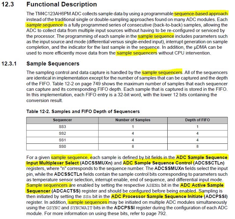

    By firm's/my read - very much of poster's curiosity is well satisfied by the MCU manual.   Having past written such manuals - this "sample sequencer" detailing does appear "reasonable."   (yet - like many things - always could be made better...)    I attach (one) key portion of the manual for review:
  • Hello Islam,
    Apologies for my over insistence on reading the data sheet. cb1- has proved that the details were insufficient (and thank you for that).
    The Sequencer is a like a sequential task list which schedules A/D conversions. Each entry requires property like, channel number, differential or single ended input, interrupt generation and end of sequence. The trigger (hardware or processor initiated) starts the execution of a sequencer and the entry corresponding to end of sequence stops the sequencer. At the end of it the sequencer FIFO contains the entry for the A/D converted value in the order of the A/D channels programmed in the sequencer MUX register.

  • Hi cb1,
    I have read this part and couldn't find it very promising. But thank you for the help.
