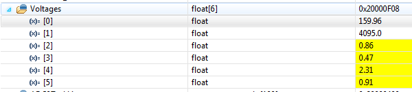

I'm using TIVA-C (TM4C123G) Launchpad. I've setup ADC0 sequencer0 to continously sample 6 channels (CH0-CH5). Also I configured µDMA in peripheral scatter gather mode to transfer the sampled data to a buffer. I have put CH0 to 3.3V and all other channels to GND.
The problem I have is, that not channel0 is the first element in the buffer. It's rotated by 1.
(see screenshot)
I cannot find the error. (Maybe in µDMA config, or ADC config?)
I've attached the whole project which can be used as is with the LaunchPad.
Thanks in advance.
BR
Christian

  • Hello Amit.
    It didn't help. There is still a rotation in the channel order.
    What I've seen is, that after the first time start of the program the order is correct (I've set a breakpoint in the ADC0SS0uDMATransferFinishedISR function). After pressing F8 (Resume) only two scatter gather transfers have the correct order and for the remaining 98 transfers the order is wrong. After pressing F8 once again, all transfers have the wrong order.
    I't seems really strange to me.
    Any other suggestions?
    Thank you
    BR
    Christian

  • Hello Amit.
    No I've only the "Expressions" window opened to see the values of the Voltages-variable.
    I've again read the data sheet of µDMA. It says that the ADC module generates a µDMA burst request when the FIFO is half full. And the arbitration size should be set to the same as the number of data items the peripheral can accommodate when making a burst request.
    This means that the burst request for ADC0 SS0 occures when it has sampled four channels. But I have configured six channels and I cannot set arbitration size to six.
    Can this be a problem?
    BR
    Christian

  • Hello Amit,
    ok, but when a burst request is generated after FIFO half full (4 values), six values will be transfered because a burst request cannot be canceled, isn't it?
    BR
    Christian
  • Hello Christian
    The Transfer size must be 6 and Arb Size as 4. So when the Burst Request is generated 4 values will be read out in Burst and the Last 2 using single requests.
    Amit
  • Hello Amit.
    With this settings rotation didn't happen. But for testing I've attached CH0 and CH5 to 3.3V and now I can see that CH0 Shows 4095 but CH5 shows 0. So something still isn't working with this.
    I've also tried to fetch the ADC data without µDMA but with ADCSequenceDataGet function called in ISR. There is also a channel Rotation happening.
    BR
    Christian

  • Hi Amit.
    Not on my Launchpad.
    Set the SystemClock to 80Mhz. => no change.
    Now I've found a working solution for me too:
    Configure the ADC SS0 to generate an interrupt after each 2nd channel and µDMA arbitration after two transfers. This does the job.
    Thanks for your help.
    BR
    Christian
