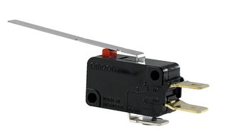

Dear all,
I'm completely new in developing on a tiva board. Till now, I've only used booster packs with some chicks (e.g. altitude click)..
Now I want to use a microswitch together with my microcontroller:
Can anyone tell me where i can find some kind of example or tutorial to use such a thing. at best from hardware view (how to connect the switch with the board) to software view (how do i have to use the gpio pins)?
Thanks in advance and br,
Patrik

  • sorry for the german version of the data sheet.
    what i want to do: on every "click" on the switch i want to get information into my task - just like an GPIO interrupt of a button on by board. it doesn't have to be a interrupt, it's also ok for me to check the "state" of the switch on a (very) regular basis to get the state.

  • It doesn't have to be this switch.
    I just need something that has this characteristic. the switch has to be activated by a smooths contact, so that e.g. a car on a carrera track can trigger it by brushing it.
    Do you know any other hardware i can use which is more suitable for a microcontroller?
    Modulated IR (infra-red) Led paired assemblies prove superior.   (i.e. avoid "smooth" or more likely "unsmooth" contact w/the vehicle)
    These devices often are installed along conveyor lines - signal the presence of objects - without in any way interfering w/their motion or progress!   The detection initiates various actions.   Commercial versions are better designed, more complete, more robust.   For hobby usage - think of devices (perhaps) targeting TV/Audio remote control.   The IR signals are modulated to (somewhat) deaden them to ambient light - and frequency filtering offers more robust "presence/passage" detection...
    Such devices - when sold as a mated pair - usually output at/around 5V signal levels - which should be easily divided to MCU (i.e. 3V3) voltage levels.
