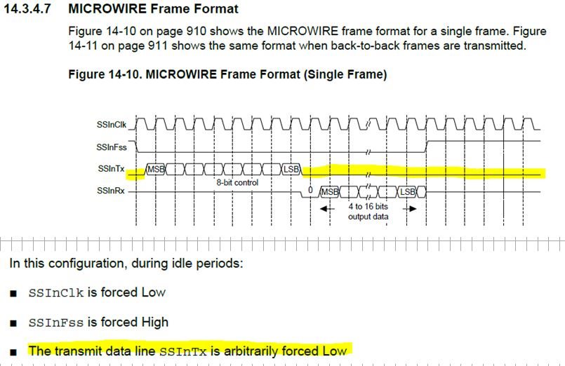

  • If the device requires/expects a logic high @ idle - and the SPI pin/port is employed - I question the (suggested use) of a pull-up.   SPI - to my knowledge - does not operate under "Open Drain" but instead via "Push-Pull."
    One poster here argued: "Use a pull-up on the SSI3XDAT0 output so than when the QSSI transmitter is idle the WS2812B data input is pulled high."   Yet - if the pull-up is strong enough to "overcome" the "normal (low) logic level provided by the MCU - is not this method, "Asking for - even inviting trouble?"
    This pull-up idea then presents the possibility of:
    • conflicting w/the (normal) MCU's SPI pin-data state when at idle
    • being over-ridden by the MCU's SPI pin-data state when at idle  (should the pull-up dominate the MCU's output - and they are in contention - the MCU may suffer damage
    Neither proves good - I'd avoid this suggestion.
    In Will's response he soldiers on w/"Delay" - note that Amit, Robert & myself have all voted for Timer usage, instead.
    Unknown (by me) is whether the use of a Timer pin tied to a "fast" GPIO Port will succeed in (further) shrinking minimum Timer Output pulse width.
  • Good for you - and HURRAY for your choice of - and success with (obviously) and reporting of such - "KISS"-based Victory!"

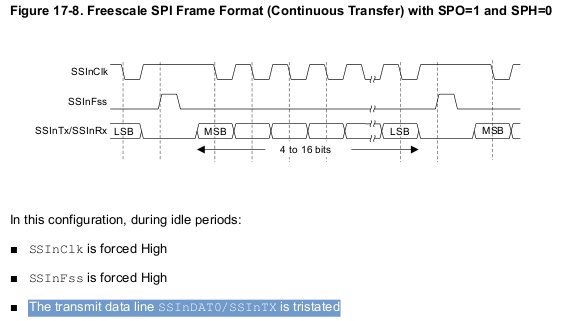

    The reason I suggested the pull-up is that the the SPI transmit data line is documented as being tri-stated during idle periods.
    I haven't tested it, but I assumed a suitable pull-up resistor value would allow the WS2812 input to be seen as a high during idle periods, but would be driven low by the SPI module when sending data (when the SPI transmit data line is push-pull).

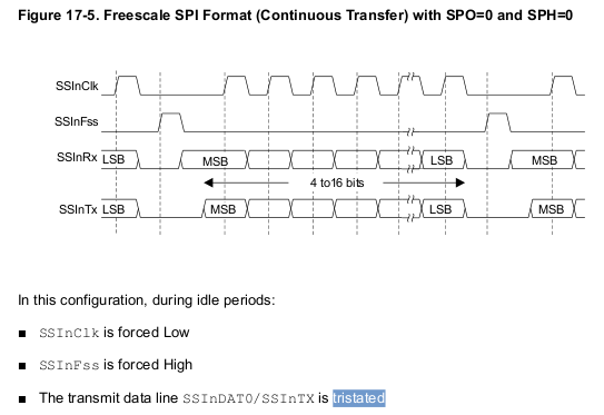

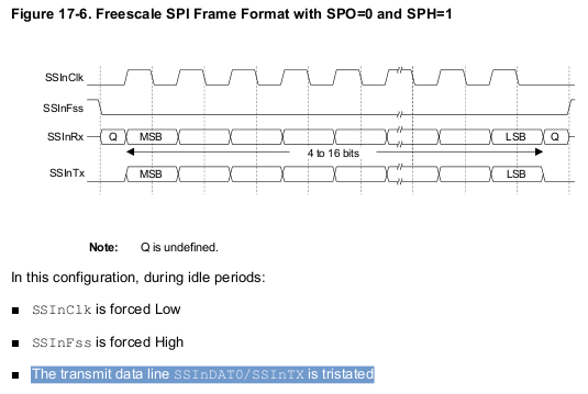

    Thank you - I don't believe that to be normal/customary practice though - certainly is NOT the case across the ARM MCU market leaders' devices.
    "Floating" the data-line usually - but not always - has the potential to "wreak havoc" upon all (signal) interconnected devices.   Firm/I are curious as to "Why this has been done?"   (and why not at/by the ARM market leaders?)
    At the minimum - that (excess) pull-up may cause some "slew" upon the SPI pin's (active) high to low transition - that is unlikely to be desirable...

    Here's confirmation not from brand "X, Y or Z" - but from this vendor's TM4C123 data-sheets:
    Note that the identical "forced to LOW" occurs in the 2 remaining "Freescale SPI Modes!"   And then Microwire:
  • cb1- said:
    Now to, "Set the record straight wrt the "Default state" of SPI_TX - I copy/paste from must current TM4C123 (not poster's - but one I have.)
    I have just doubled checked the TM4C1294NCPDT data sheet and for the TM4C129 series QSSI module the transmit data line SSInDAT0/SSInTX is reported to be tristated whenever the QSSI is idle, in all modes:
  • Look again - and more closely - 100 (USD) says that's "Cut/Paste" ERROR!
    The timing chart is JUST as I described - SSIxTX drives LOW.
    There is NO advantage to floating that line - none - foolish to persist...
    Looking back at the history in the TM4C129 datasheet it appears there was a deliberate change to the text describing the operation of the transmit data line when the QSSI module is idle in the Freescale SPI Frame Format.
    1) In the TM4C129XNCZAD datasheet dated October 19, 2013:
    a) The Texas Instruments Synchronous Serial Frame Format section says:
    In this mode, SSIClk and SSIFss are forced Low, and the transmit data line SSInDAT0/SSInTX is tristated whenever the QSSI is idle.
    b) The Freescale SPI Frame Format sections say:
    In this configuration, during idle periods:
    ■ The transmit data line SSInDAT0/SSInTX is arbitrarily forced Low
    2) In the TM4C1294NCPDT datasheet dated June 18, 2014:
    a) The June 2014 revision history says:
    In SSI chapter:
    – Noted that during idle periods the transmit data line SSInTx is tristated.
    b) The Freescale SPI Frame Format sections have been changed to say:
    ■ The transmit data line SSInDAT0/SSInTX is tristated
    While I haven't myself tested the behavior of the QSSI transmit data line in Freescale SPI Frame Format, my guess is that the text is correct and the issue is that the Freescale SPI Format timing diagrams weren't updated to show the transmit data line SSInDAT0/SSInTX being tristated when idle.
    Perhaps Amit can clarify this, and request the datasheets are updated to ensure the text and timing diagrams are consistent.
