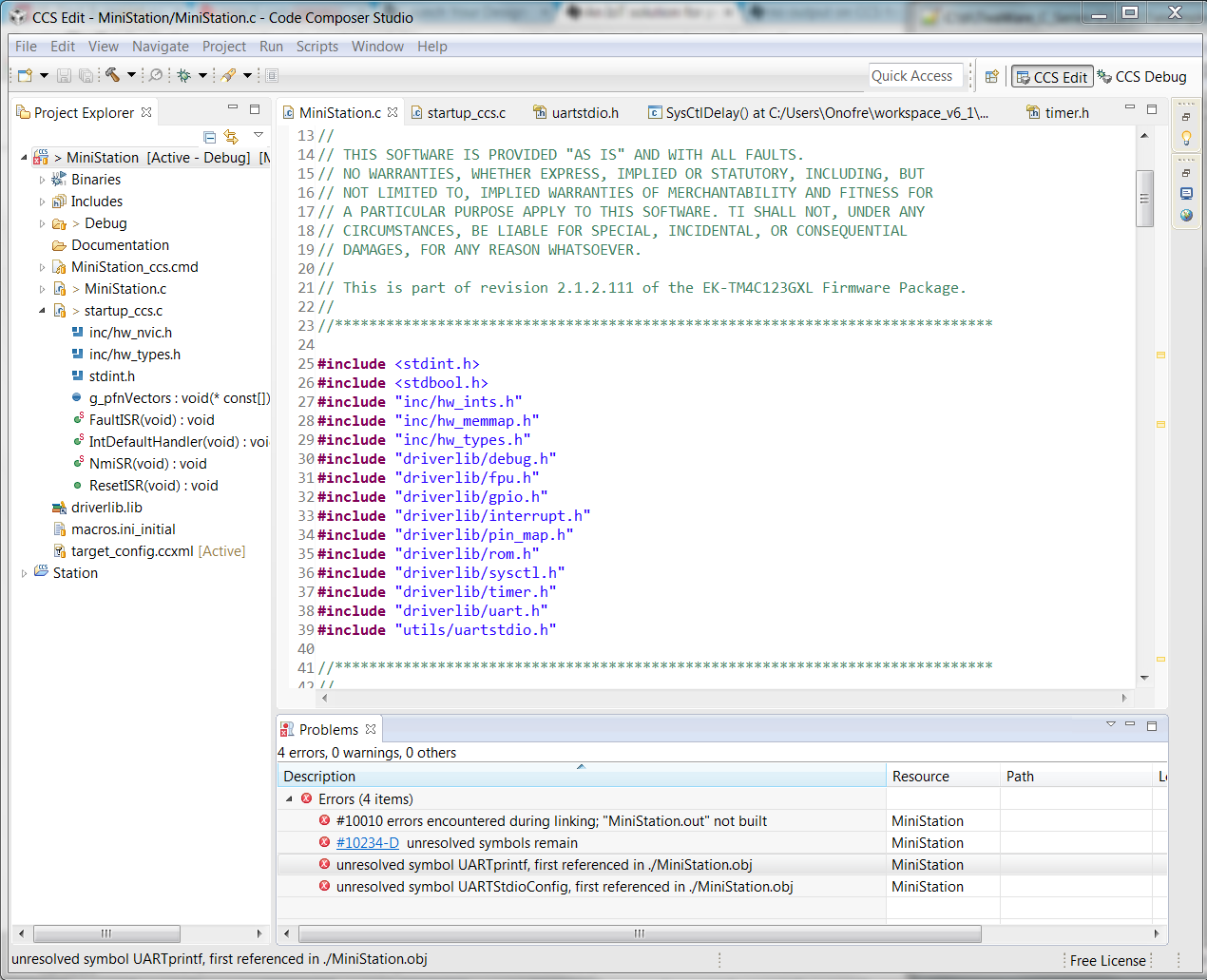

I've been trying to use the UartPrinf function from utils/uartstdio.h, but ccs doesn't recognize the library function.
I dont know what I need to do to correct use this library.
When I run the TI examples, it works. But, If I try to write by myself, it doesn't...

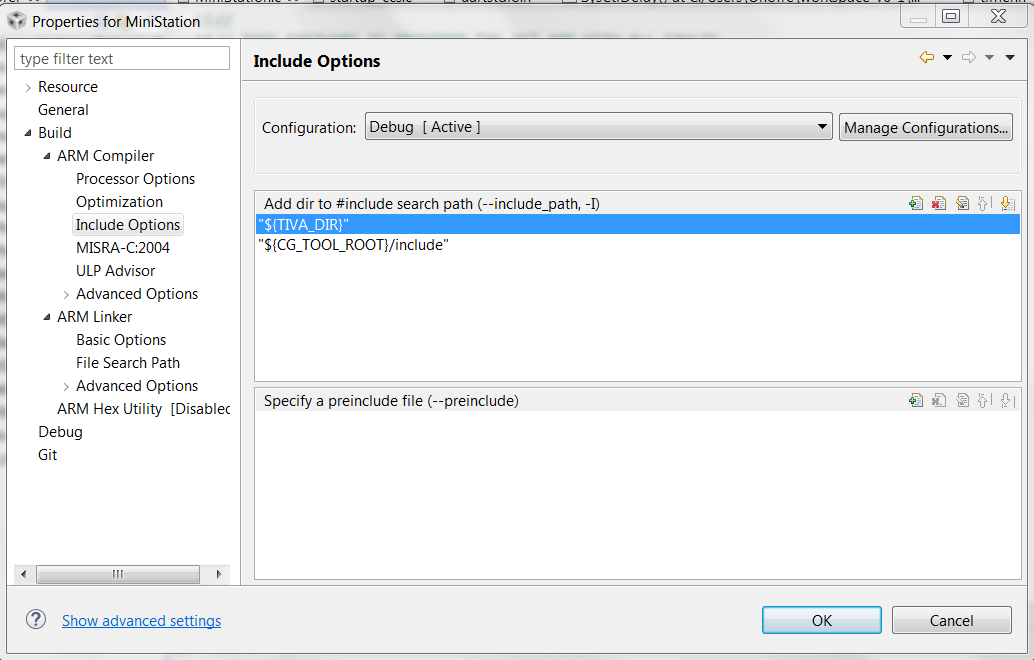

I created a variable path called tiva_dir. It point to where I installed tivaware. The most weird is I can use, for example, driverlib without any problems. CCS can find it, but not the function I need.
This is the error.
Description Resource Path Location Type
unresolved symbol UARTStdioConfig, first referenced in ./MiniStation.obj MiniStation C/C++ Problem
  • Uartstdio is not part of the driverlib, it is in the utils folder with several other useful modules. By default, uartstdio.c is not compiled thus not linkable. You have to add uartstdio source and header files to your project with correct path links in project properties.

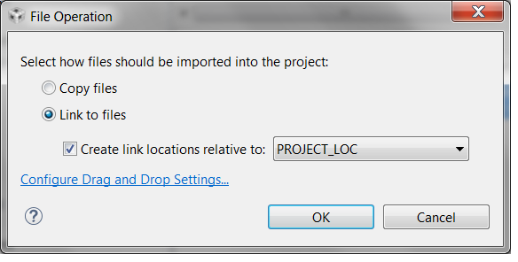

    I've just tried to add uartstdio.c and .h into my code.
    Then, I clicked in Add files and I chose Link filles to my project directory.

  • I've just figure out how to do it.
    utils/uartstdio is not compiled, as JustGreg replied.
    Then, the problem was: how to add this file in my project.
    These are the steps:
    Click in: project>> New>>Folder
    Select the folder name. I did Utils, for example.
    Click in Advanced and select Use default location
    Left click on the new folder
    New>> File
    Click in Advanced
    Select: "Link to file in the file system"
    Click in Browse...
    Find the Utils/uartstdio.c
    It is done!
    Compile, and the uartprintf works!
