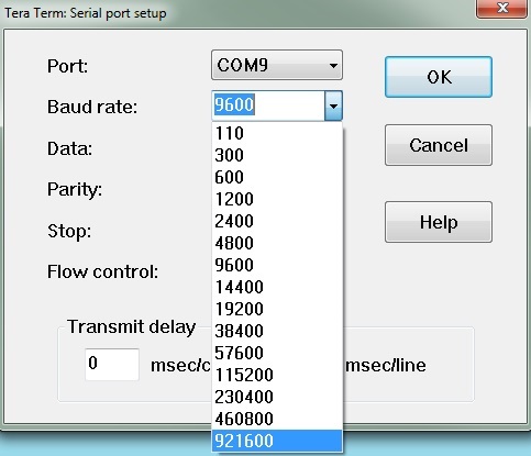

  • Thank you for reply my question. I coltrol a mortor end sample time is 50uS . I need transfer date from TIva to Pc monitor . I think UART is not enough speed , i think that I should use Usb in regular speed , I don't have enough experience use it. Could you please consult me for some think. Thank you so much

  • Hello Vu,
    That is a very good point you brought up. I did not think about the limitation on terminal window applications.
    I don't know of any terminal utility that can do a 5Mbs speed. However Tera Term utility can communicate with speeds upto 921600 bits per second (see screenshot below), which means you could transmit about 5 bytes in 50us. Not sure if that is enough for your application.
