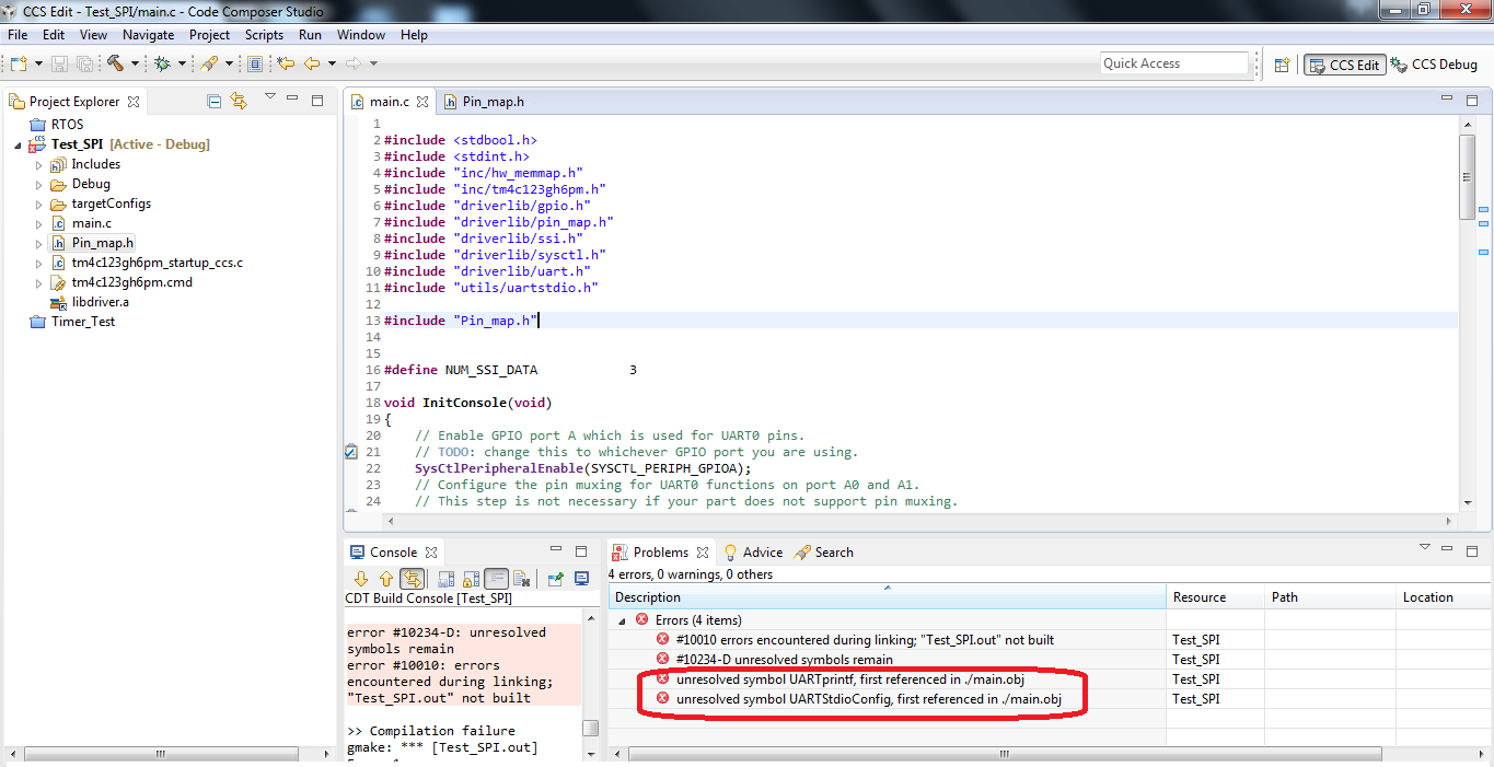

    now i am getting error like
    Description Resource Path Location Type
    unresolved symbol UARTprintf, first referenced in ./main.obj
    unresolved symbol UARTStdioConfig, first referenced in ./main.obj
    Plz tell why these errors are occurred. I am shown below my code and error also.

  • Hello Yuvaraj,
    You need to add the file uartstdio.c in the compilation flow by using Import option.
    I would suggest using a known UART project as a starting point.
    Amit
