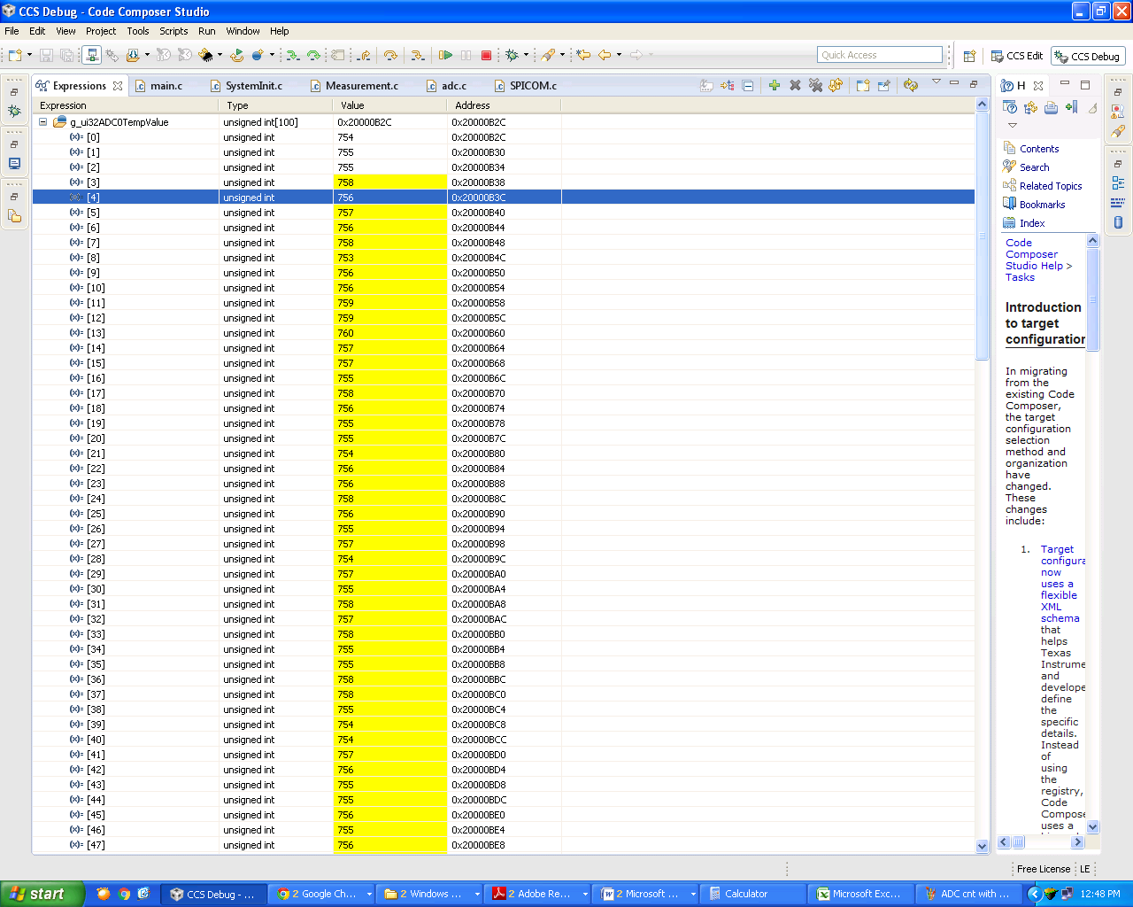

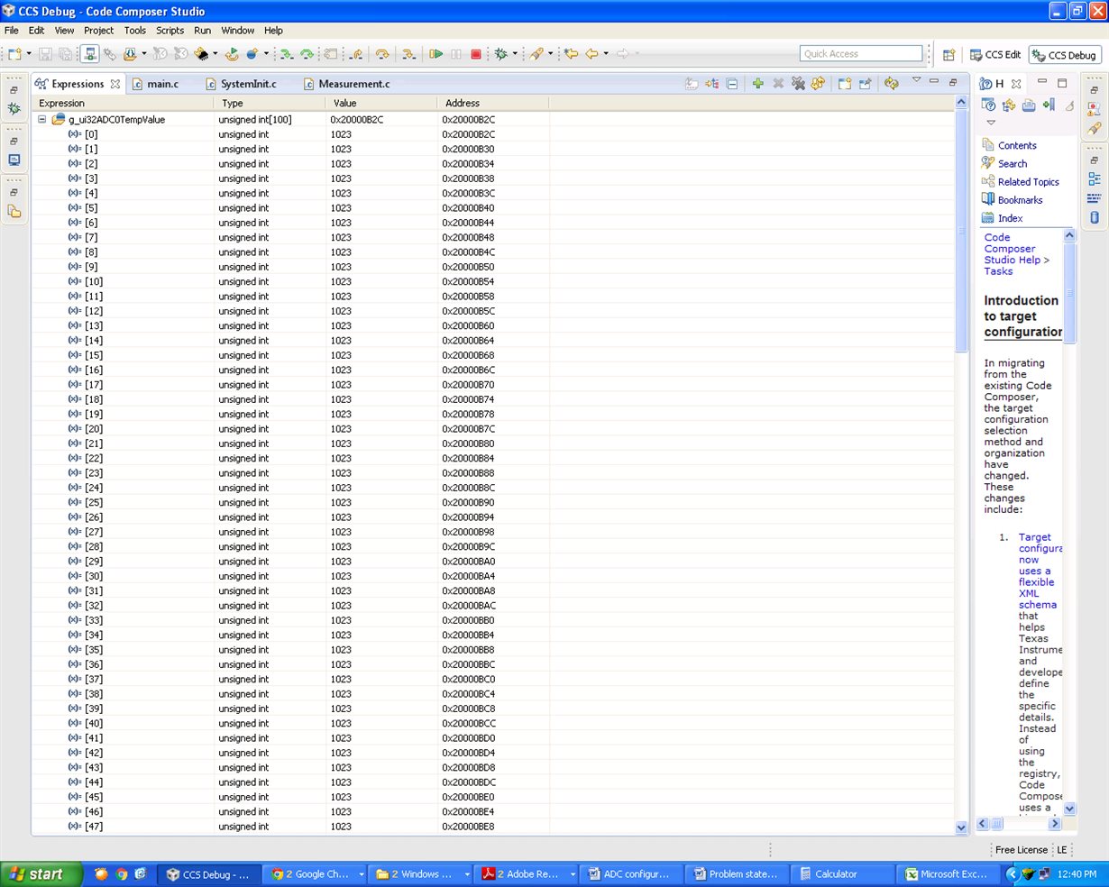

Whenever the input to ADC is given corresponding to 2^n-1 (ie 2047,1023, 511, 255,127,63 etc) value then ADC count is freezing to the corresponding 2^n-1 value. We collected these data in a array of 100 values at every 125mS. All values are getting rock steady to these magical values(2^n-1). Input to ADC is DC with some unwanted noise,so as per the input, the ADC count should vary  in between 5-15 counts but as soon the ADC count reaches to these magical value there is no single count variation.For other count values it is working as expected.
To come out of these magical values the input need to change substantially in value corresponding to  20 - 30 counts.It will work fine as soon as it come out of the magical value.These problem is happening in measurement ch1 as well as measurement ch2. One more finding is, problem in one channel is not affecting other
Test case:
742mVDC is corresponds to 1023counts and these counts remain constant for a input variation from 735mVDC to 780mVDC .But actually it should vary from 1013 to 1076counts.For other than magical values ADC counts varing corresponds to the input variation even for 2mVDC
 Please find the attached for code snippet,results and block diagram.

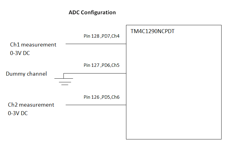

  • satheesh kumar said:
    ...the remaining two used as a Dummy channel to avoid cross talk between measurement channels.Input to the Dummy channel is connected to ground to ensure 0 input
    Excellently composed & detail-rich post - Bravo!
    Firm/I have used these & predecessor parts coming upon ten years - never/ever have we noted such an issue!   (and we have "swept" the ADC inputs - so surely we've introduced your, "magic ADC values.")
    Now your attempt to "avoid" cross talk - as described w/in the quote - I believe "fails" as the 0V introduction will tend to "weaken" the following reading.   Might the "back to back" presentation of the SAME Channel data - instead - prove the best means to "avoid or reduce" such cross-talk?   I'd discount the first reading - accept & process (only) the 2nd reading - thus the first reading serves as a "cross-talk reducing" dummy reading.  (this is so as the "difference between signal levels - upon consecutive ADC steps - reveals the greatest "cross-talk" levels."   Thus - should your desired signal swing far from ground - you've "encouraged" (not avoided) such cross-talk by the introduction of 0V!)
    Absent in your (otherwise) excellent report is the "population of boards" which reveal this issue.   The diagnosis may vary greatly based upon the number of boards impacted.
    As a swag - I'd suspect your unpacking & read of the FIFO - rather than an MCU "sensitivity" - to such "magic" voltage levels...

  • And (clearly I've too much "free time" today) might this "magic/stuck" reading suggest an unwanted switch from, Single-Ended to Differential ADC configuration?   And/or a, "tracking" between these 2 subject ADC Channels?
    Robert's suggested "measure everything" should include (simultaneous) measure/monitor of BOTH suspect channels.   And poster should fully describe "how each errant ADC channel is being driven" and how the changed voltage level at one channel effects (if at all) the voltage level at the 2nd channel.  (such was "touched on" by poster - yet not fully detailed)

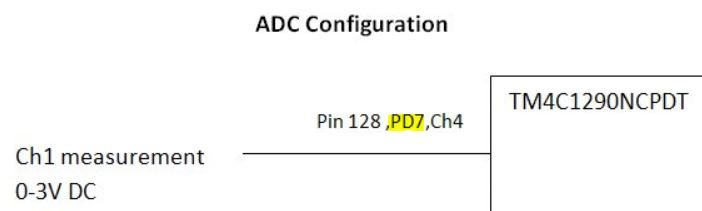

  • Just noted that the (always) delightful "NMI" afflicts your PD7 - and you've "failed" to free that pin from its NMI BURDEN!
    *** this PD7 as NMI inflicts 4C123 - I don't know if this extends to your 4C1290!   Surely worth the mention...
    Per usual - vendor minimizes their "deviations" and PF0 & PD7 (partners in NMI crime) appear briefly (in mice type) w/warning of this insidious (and always unwanted) default behavior.
    Clearly you need to exit from PD7 (too risky IMO) and employ another ADC pin - & repeat your testing.
    I've no explanation for the effect you've presented - yet using any "locked pin" w/out unlocking - clearly proves NOT "best/brightest."   Suggest that you flee - quickly & far from PD7 - and employ a "normal" (mice-type free) ADC pin.
  • Dear Robert,
    Thanks for the prompt reply.
    Yes what you said is correct.The culprit is Vref to the ADC.We did not used 1uF and 0.01uF capacitor to the output Vref circuit because of the oscillation issue since we are generating a 3V ref from a 2.5V voltage regulator using Op-Amp. this Op-Amp tend to give oscillations when capacitor is connected at its output.
    Finally now we again used those capacitors with some additional circuit to eliminate osculations
    Now ADC is not freezing at those magical values.Only question remaining is why ADC is freezing at only those magical values when it is working with all other values perfectly
    Thanks once again robert .your valuable suggestions helped us to arrive the solution
