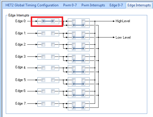

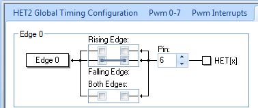

1- I setuip Edge 0 on Falling Edge for HET2[6]:
2- Then I setup Edge0  Interrupt to be LowLevel

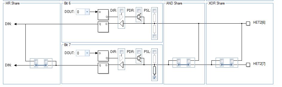

2- Then under PIN0-7 I configured HET2[6]
3- After I setup the PINMUX to activate HET2_6
4- Then under VIM Channel 0-31 I activate Channel 24 HET Low
5- And then I generate the Code in halcogen.
