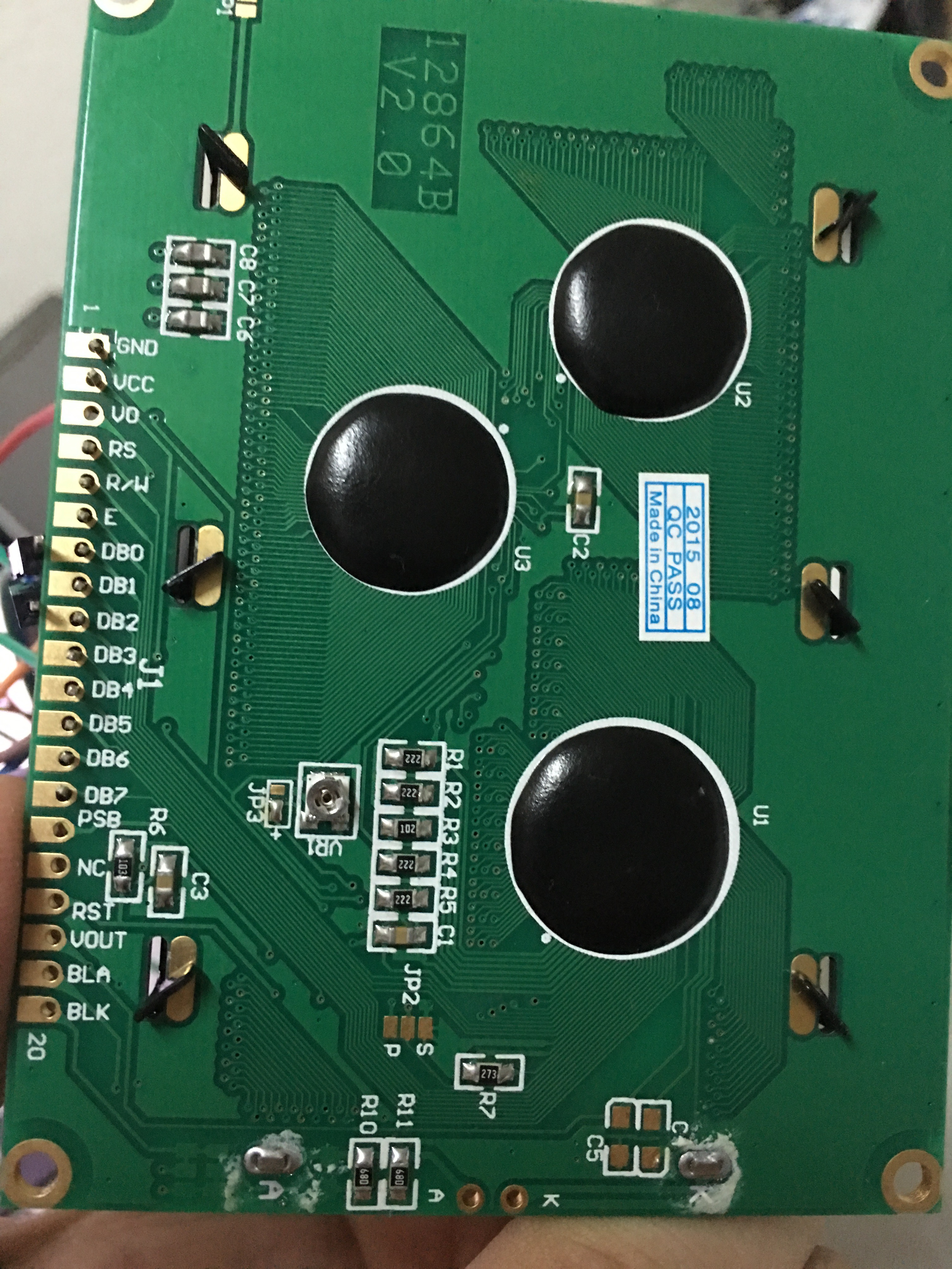

  • Thank for advice, i used 12864B V2.0, Driver IC: ST7920, you can see it there: thegioiic.com/.../lcd12864
    This is datasheet of ST7920: www.waveshare.com/.../ST7920.pdf
    And datasheet of ST7921: www.waveshare.com/.../ST7921.pdf

  • Thanks for those links & for the high res. photo.
    I note the following:
    • your connections do NOT appear to be soldered.   Is that the case - and you rely upon (famed) "friction fit" for connection integrity?
    • Pin 3 "Vo" is the contrast pin - and it appears empty!   (i.e. No connection in evidence)   Note that I mentioned "bad or missing contrast voltage" and if pin 3 "is" as it appears (empty/open/floating) all of the logic analyzers in the world will not yield one pixel!
    Relying upon "friction fit" for connection is not recommended!   You must install a proper header/receptacle - or properly solder those connections.   Should the power pins (1 & 2) become (even momentarily) dislodged during operation - and voltage is applied to any other display pin - damage usually results!  Not good!
    Can you read the display manual - and identify the appropriate contrast voltage?   That's good training - as is following (all) direction.   Usually a pot is employed which enables variable voltage to be applied to the contrast pin - so that the most viewable pixel field results.
    [edit] 21:57 CST: I've opened the ST7920 control chip manual.   I've seen and (once/twice) used this chip - but (only) on a 144x32 Lcd.   And - while I've not performed an in-depth read - it does appear that this chip can accept ASCII data & produce full, legible characters - even in Chinese.   Again - I've never seen this chip used on a 64 pixel row display.
    Page 18 of ST7920 manual lists the initialization instructions.   You must get these right - often in the proper sequence & in full observance of the specified display timing.  (your MCU is many, many times faster than the display)
    What remains missing - is the Display Data sheet.   ST7920 & ST7921 are controller & lcd drivers - neither exposes what the display designer has specified for the contrast pin.  (pin 3)   That data should have been included w/the display.
    While the display is very capable - it demands great attention to detail to bring fully & properly to life - thus it violates "KISS."  (it is not simple)   I'd much prefer to see you succeed w/plain character display first - only after that learning & confidence-building - venture onto this demanding display...
    As a point of note - another (highly popular here) ran into issue w/this vendor - very recently.
    With proper contrast voltage applied to pin 3 - the pixel field should "just be visible" when the display is powered, fully & properly initialized and the "Display On" command is executed .   You've missed this guidance TWICE - please do note and correct - this time...
  • Thanks a lot, finally it working.
    It not working b/c i miss pin BLA and BLK and some reason cb1_mobile suggest.

    //DB0,DB1
    GPIOPinWrite
    (GPIO_PORTH_BASE,GPIO_PIN_1,0x00);
    //DB2
    GPIOPinWrite
    (GPIO_PORTM_BASE,GPIO_PIN_4,0x00);
    //DB3
    GPIOPinWrite
    (GPIO_PORTE_BASE,GPIO_PIN_4,0x10);
    //DB4
    GPIOPinWrite
    (GPIO_PORTE_BASE,GPIO_PIN_5,0x20);
    //DB5
    GPIOPinWrite
    (GPIO_PORTN_BASE,GPIO_PIN_4|GPIO_PIN_5,0x00);
    //DB6, DB7
    //RS/RW
    GPIOPinWrite
    (GPIO_PORTB_BASE,GPIO_PIN_4|GPIO_PIN_5,0x00);
    //RS|RW
    //EN
    GPIOPinWrite
    (GPIO_PORTK_BASE,GPIO_PIN_2,0x00);
    delay(16800);
    GPIOPinWrite
    (GPIO_PORTK_BASE,GPIO_PIN_2,0x4);
    delay(12000);
    //display-on-Off
    GPIOPinWrite
    (GPIO_PORTA_BASE,GPIO_PIN_4|GPIO_PIN_5,0);
    //DB0,DB1
    GPIOPinWrite
    //DB2
    GPIOPinWrite
    (GPIO_PORTM_BASE,GPIO_PIN_4,0x10);
    //DB3
    GPIOPinWrite
    (GPIO_PORTE_BASE,GPIO_PIN_4|GPIO_PIN_5,0x00);
    //DB4&DB5
    GPIOPinWrite
    //DB6, DB7
    //rs-rw
    GPIOPinWrite
    //en
    GPIOPinWrite
    SysCtlDelay
    (12000);
    GPIOPinWrite
    SysCtlDelay
    (12000);
    //display clear
    GPIOPinWrite
    (GPIO_PORTA_BASE,GPIO_PIN_4,0x10);
    //DB0
    GPIOPinWrite
    (GPIO_PORTA_BASE,GPIO_PIN_4,0x00);
    //DB1
    GPIOPinWrite
    //DB2
    GPIOPinWrite
    //DB3
    GPIOPinWrite
    //DB4&DB5
    GPIOPinWrite
    //DB6, DB7
    //RS-R/W
    GPIOPinWrite
    //EN
    GPIOPinWrite
    delay(1200000);
    GPIOPinWrite
    SysCtlDelay
    (1200000);
    //ENTRY-MODE-SET
    GPIOPinWrite
    //DB0
    GPIOPinWrite
    (GPIO_PORTA_BASE,GPIO_PIN_5,0x20);
    //DB1
    GPIOPinWrite
    (GPIO_PORTH_BASE,GPIO_PIN_1,1);
    //DB2
    GPIOPinWrite
    (GPIO_PORTM_BASE,GPIO_PIN_4,0);
    //DB3
    GPIOPinWrite
    (GPIO_PORTE_BASE,GPIO_PIN_4|GPIO_PIN_5,0);
    //DB4&DB5
    GPIOPinWrite
    (GPIO_PORTN_BASE,GPIO_PIN_4|GPIO_PIN_5,0);
    //DB6, DB7
    //RS-R/W
    GPIOPinWrite
    (GPIO_PORTB_BASE,GPIO_PIN_4|GPIO_PIN_5,0);
    //EN
    GPIOPinWrite
    (GPIO_PORTK_BASE,GPIO_PIN_2,0);
    SysCtlDelay
    (2000000);
    GPIOPinWrite
    SysCtlDelay
    (1200000);
    //WRITING 0x41 "A" to DATA-bus DB0-DB7
    GPIOPinWrite
    //DB0
    GPIOPinWrite
    (GPIO_PORTA_BASE,GPIO_PIN_5,0);
    //DB1
    GPIOPinWrite
    (GPIO_PORTH_BASE,GPIO_PIN_1,0);
    //DB2
    GPIOPinWrite
    //DB3
    GPIOPinWrite
    //DB4&DB5
    GPIOPinWrite
    (GPIO_PORTN_BASE,GPIO_PIN_4,0x10);
    //DB6,
    GPIOPinWrite
    (GPIO_PORTN_BASE,GPIO_PIN_5,0);
    //DB7
    //RS-R/W
    GPIOPinWrite
    (GPIO_PORTB_BASE,GPIO_PIN_4,0x10);
    //RS
    GPIOPinWrite
    (GPIO_PORTB_BASE,GPIO_PIN_5,0);
    //R/W
    //EN
    GPIOPinWrite
    SysCtlDelay
    (12000);
    GPIOPinWrite
    while
    (1){
    GPIOPinWrite(GPIO_PORTN_BASE,GPIO_PIN_0,1);
    delay(period/2);
    GPIOPinWrite(GPIO_PORTN_BASE,GPIO_PIN_0,0);
    delay(period/2);
    void
    delay(uint32_tnum){
    TimerIntClear(TIMER0_BASE,TIMER_TIMA_TIMEOUT);
    TimerConfigure(TIMER0_BASE,TIMER_CFG_PERIODIC);
    TimerLoadSet(TIMER0_BASE,TIMER_A,num-1);
    // TimerIntEnable(TIMER0_BASE, TIMER_TIMA_TIMEOUT);
    TimerEnable(TIMER0_BASE, TIMER_A);
    while(!TimerIntStatus(TIMER0_BASE,false)){
    Haroon
