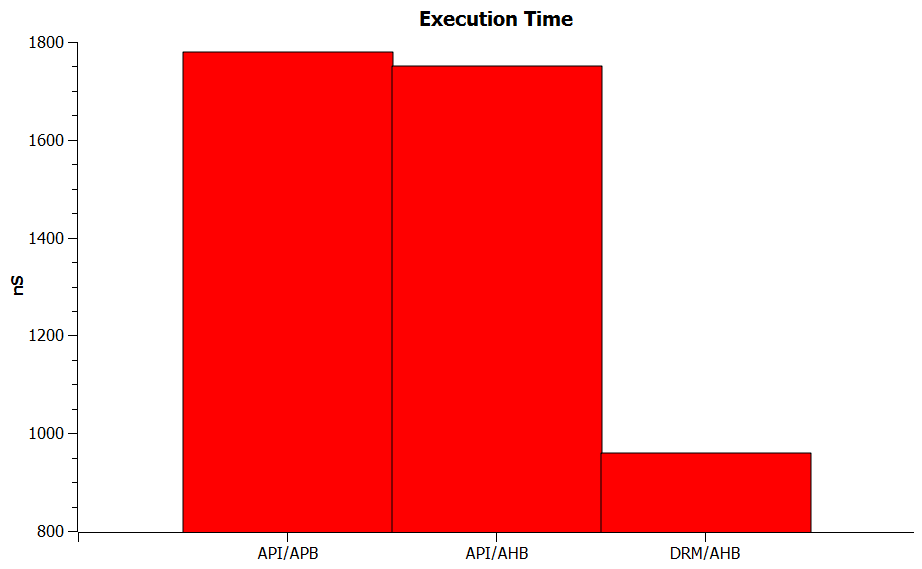

    So when initialising the array holding the timer load values, I simply made every element equal to zero such that, when the timer is re-enabled at the end of the interrupt handler, having already been loaded with a starting count value of 0, it will already be at 0 and therefore immediately generate the interrupt so that the same interrupt handler runs again. I also put alternating 1's and 0's into the GPIO output value array, so that it outputs a regular square waveform. I also made sure not to include any unnecessary extra API or Direct Register writes when obtaining the results. Just the bear essentials. I measured the pulse widths with a GW Instek oscilloscope. So:
    Within the interrupt handler in each experiment in the following order:
    -cleared the timer interrupt so that it no longer asserts.
    -Disabled the timer.
    -incremented interrupt counter variable.
    -loaded timer value
    -wrote the desired pin output
    -enabled timer
    Execution time via API and APB bus is 1780ns.
    Execution time via API and AHB bus is 1750ns.
    Execution time via DRM and AHB bus is 960ns.

  • Agreed thanks,
    I'm a little surprised that a master's thesis is run through an automated plagiarism filter but I suppose once it's paid for... I just would have thought that assurance to be the job of the advisor and committee.  However, different systems for different places and I've been away from that for some time.
    So as a visual indicator see the following (side note, apparently the forum can't deal with SVG images)
    Robert
