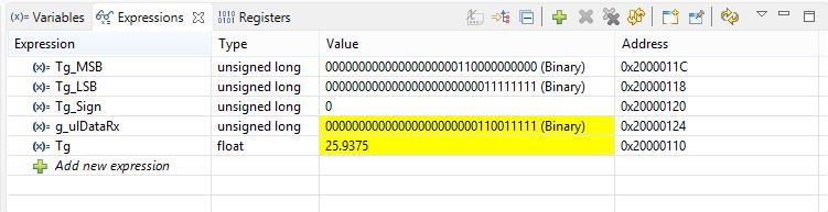

I'm using LM92 as part of a datalogger project, connecting to microprocessor through I2C. I've got the libraary to work after a few shots, but now I'm having an issue. First byte is always a correct value, but the problem comes when I get my second byte, that is always 11111111. Getting rid of those 3 state bytes, so we have 00011111. The result is that when I convert it to a float, I always get xx.9375, hence always an error.
So I tried the sensor using Energia, and there it seems to be working fine.

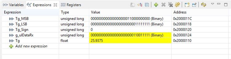

I'm attaching my code and a debug screenshot. If anyone would see what am I doing wrong, I would really appreciate it!
Thanks!
Franco

  • Hello Franco
    The first thing to check is whether the data being sent on the physical line match up to the debugger data.
    The second this is configuration of the device. These temp sense devices have a means to control the accuracy of the readout which then must be correctly done in the software.
    The last thing is the data format as sent by the device may also be in a format where the software needs to perform the relevant bit shift. Can you double check the same?
    Amit
  • Hi Amit,
    thanks for the quick reply! Regarding physical data, I'll have to check that as soon as I can get my hands on my oscilloscope, since someone borrowed it from me. But I've been wanting to do that these last days.
    About the configuration register, I've haven't used it, only to start low power mode on the device. But the thing is, code used in Energia doesn't configure this register either, so it makes me doubt what the problem might be on my CCS code. Still, I'llt ry to configure it in a different way to see if I see any change.
    Lastly, temperature's format is a 16 bit value, two's complement format for negative numbers. And three least significative bits are sensor's state. So I take my first measurement, MSB, and shift it 8 bits to the left. I take my second measurement, LSB, and then add MSB to LSB. Last thing I do is shifting final value 3 bits to the right to get rid of state bits.
    As far as I've seen, I always get the .9375 part, no matter what I do on the code.

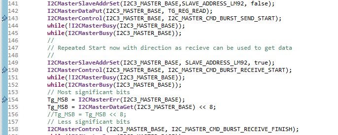

  • Hi Amit,
    thanks again for the reply. I found my mistake, and was a really dumb one I have to say. Temp was changing, ACK was working fine, LowPow wasn't doing any difference. So I tried with a different code and saw that my mistake was the way I was setting my breakpoints to debug. After I set my breakpoint after getting my I2C data, it started working fine.
    Thanks again for your tips.
    Franco

  • Adding a screenshot with breakpoints that weren't working. Clearing them and adding only one after the whole I2C process finishes did the job.
  • Merci beaucoup mon (nouveau) ami.
    Much appreciated - handle that board w/(great) care - it is not replaceable!
  • Hello Franco
    Note, that the I2CMasterBusy condition has been used with both true-false condition. Putting a breakpoint before can create conditions for such a case to occur,\,
    But thanks for posting the image: A good case of where not to put a Break Point.
