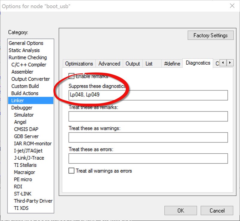

The BootLoader project performs its own .bss initialization and does not need this call.
I found that putting "Lp048, Lp049" options in Linker-->Diagnostics->Suppress These Diagnostics  solved the problem and generated the correct code.
