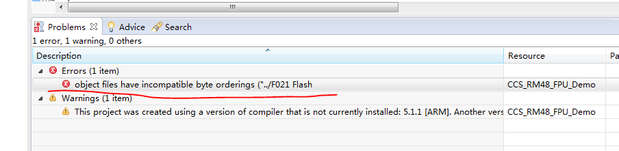

i run into a problem when using F021 Flash.
After adding F021_xxx.lib into my project(ccs6), the ccs report "object files have incompatible byte orderings".
see my attachment.
  • What version of the compiler are you using? I created a HALCoGen project for an RM48L952 and included the library "C:\ti\Hercules\F021 Flash API\02.01.01\F021_API_CortexR4_LE_V3D16_NDS.lib"  without an error. This was with compiler version 5.2.6.
