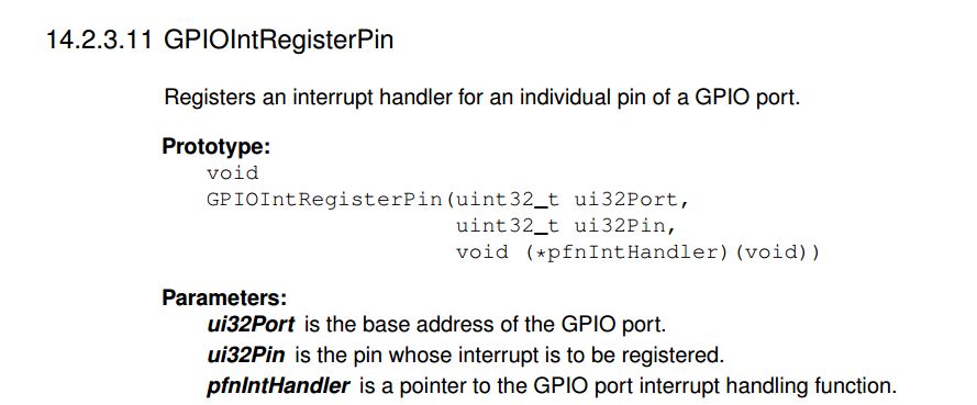

We are using Tivaware version 2.1.2.111 with a TM4C1292NCZAD processor and have an issue and a feature request for the GPIO library.
Issue:  The Tivaware call to GPIOIntRegister() asserts because the call to _GPIOIntNumberGet() returns zero.
The _GPIOIntNumberGet() function returns zero when the calling function passes in GPIO_PORTR_BASEGPIO_PORTS_BASE, or GPIO_PORTT_BASE because these entries are not defined in the g_ppui32GPIOIntMapSnowflake map.
Feature Request: We would like a function to register/unregister individual pin interrupts for port P and port Q.
We wish to take advantage of the individual pin interrupts available on port P and port Q.
So it would be convenient if Tivaware could provide something like  GPIOIntRegisterPin(ui32Port,, ui8Pin, void (*pfnIntHandler)(void)) and GPIOIntUnregisterPin(ui32Port,, ui8Pin) functions to do this.

  • Actually, even the suggested function name was applied!
    It's available in Tivaware 2.1.4.178, here's the UG:
    Bruno

  • cb1_mobile said:
    "Is it true that this MCU's "Start-Up" file reveals the presence of, "Individual Interrupt Handlers - on a "Port-BIT" basis
    Yes, it is. Here's an excerpt of one CCS startup file I quickly opened here:

    Whenever possible, we here also prefer to configure things on this file because the IRS respond quicker, which is important for really time-sensitive interrupt routines.
    In other cases, for clarity of coding and convenience of a standard library, the registration can be done on a run-time manner like the one discussed here.
    RELEVANT to note that it is always possible to identify which pin has caused the interruption to trigger on a "standard port", i.e. port A. So if any of the posters or readers here are looking for this subject because they want to find out which of the 8 pins have triggered the ISR, be aware that one does not need individual pin interrupt for such.
