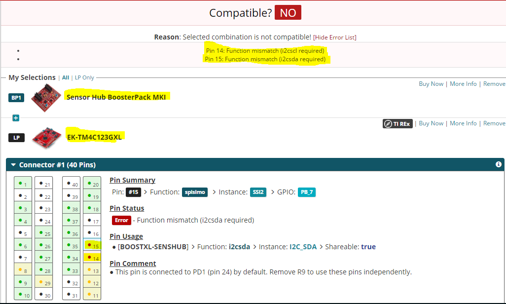

Hi ,
I'm using Booster pack Checker tool to check the compatibility between the launchpads and booster packs
and I want to use sensor hub booster pack with TM4C123GXL and it seems that there are compatible
but when I used the checker tool
the result was incompatible
https://dev.ti.com/bpchecker/#/?lp=EK-TM4C123GXL&bp1=BOOSTXL-SENSHUB
Can any one guide me for a solution for such problem ?
