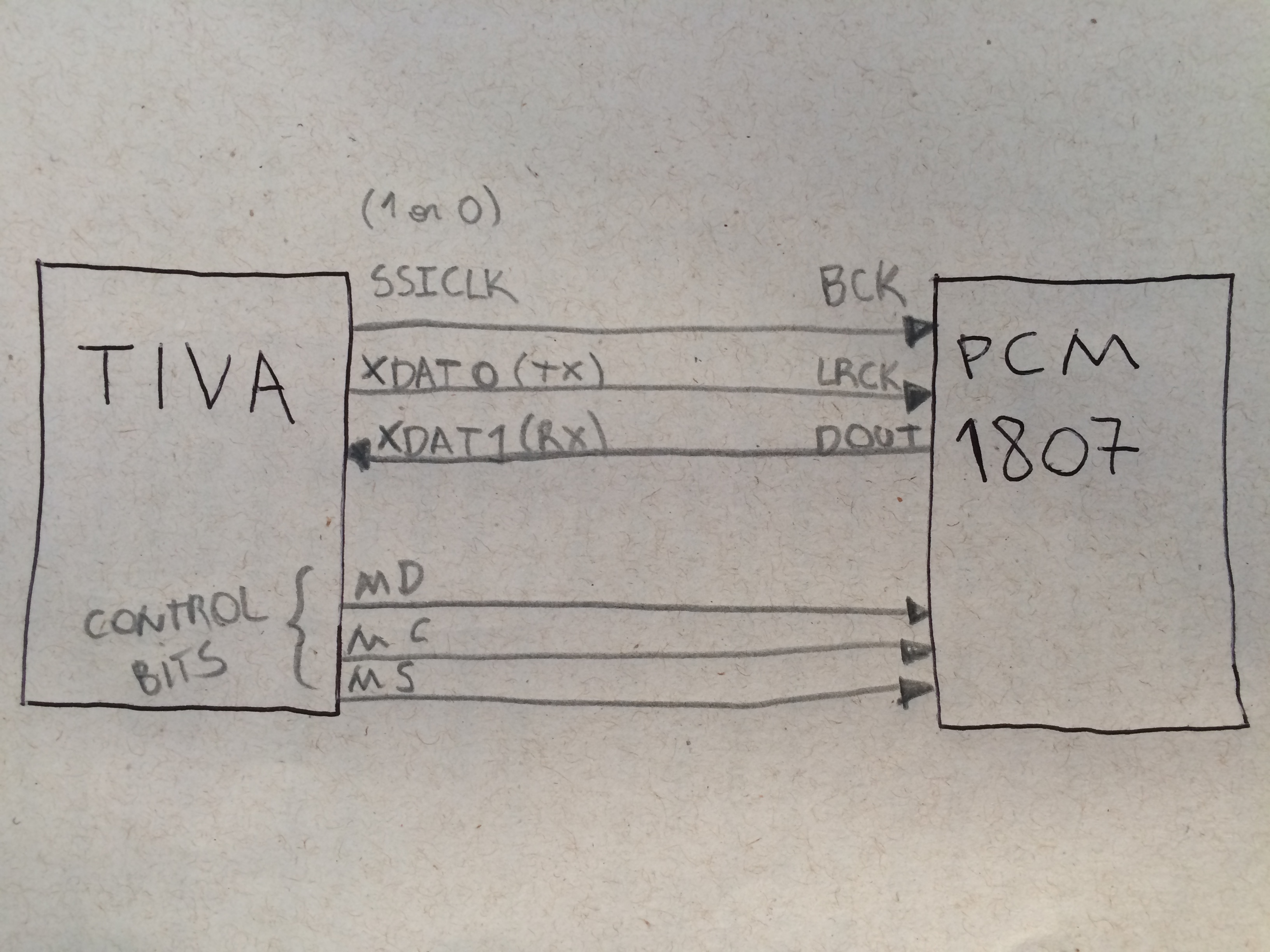

These three lines are drawn on page 2 of the first document. There I have SSI CLK hooked to BCLK, SSI TX hooked to DIN and SSI FSS hooked to WCLK, and another configuration lines for other purposes.

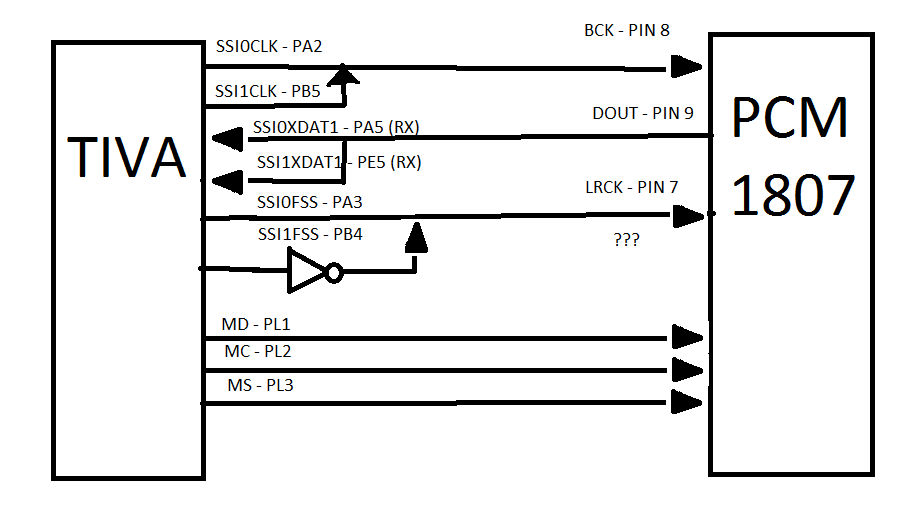

However, I want my TIVA to be the master, so I did this drawing (in advance apologies for the quality)
So I did that associations taking as example the I²S emulation on the first document. So my first question.
I believe I'd have a problem hooking SSI0CLK and SSI1CLK together, right? I mean, since the TIVA will dictate the CLK, I don't need both SSI0 and SSI1 to send clock, right?
Another detail is that in the PCM 1807 datasheet, page 14, I have that if the PCM is working as SLAVE, LRCK and BCK are INPUT pins.But I believe that LRCK "says" right or left side, so that should be coming OUT of the ADC, or not?
For now, my last question is regarding the MC, MD and MS configuration pins. On the pages 22/23/24 of the ADC datasheet, I have the detailed explanation of how to work with MC, MD and MS in order to configure the ADC. So I planned to use three GPIOs from TIVA to set LOW and HIGH on MC, MD and MS. Considering correct previous PIN configuration, I did this:

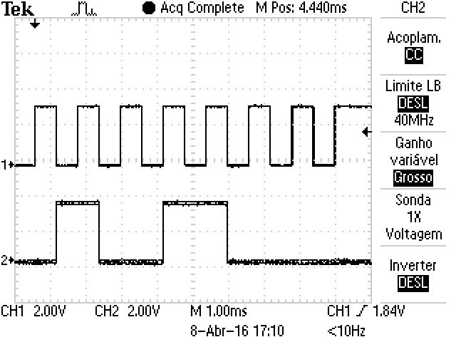

I did a test last week and I got this (MC is wrong)
Thanks again!

  • Hello Alex
    I think the I2S emulation document was targeted for TLV320AIC codec. Wouldn't it be more useful as well to use the known "good" setup to meet the requirements?
    Amit

  • Hello Alex,
    Note that the original document uses TLV320AIC as the Audio Codec which has an IO configuration different from PCM1897 part. Secondly, the clock from TIVA are being wire-ANDED together. Not a good idea and neither is the wire AND of the two FSS signals (which are in opposite polarity). There is bus contention on two critical signals.
    Amit

  • Hello Alex,
    One solution would be to use the Bi-Write mode. In this mode the SSICLK can remain the clock, XDAT0 becomes the LRCK and XDAT1 becomes the data. However this approach would require that the data being sent needs to be processed by the micro. As an example if you wanted to send data "4'b1111" serially, then when sending with LRCK low you would need to write "8'b10101010" so that the even bits go to XDAT0 for LRCK and odd bits go to XDAT1 as the data.
    Amit
  • Hello Amit - Thanks again for the feedback.
    So with this configuration (Bi-Write mode), I won't need both SSI0 and SSI1 to work, since I'll use SSI0CLK for clock, SSI0XDAT0 (TX) for LRCK and SSIXDAT1 (RX) for DOUT - I think.
    However, you said if I wanted to *send* data, but I'd be *receiving* data, right? Or you mean that SSI0XDAT0 and SSI0XDAT1 won't be in Legacy mode -  then working as Bi-directional data?
