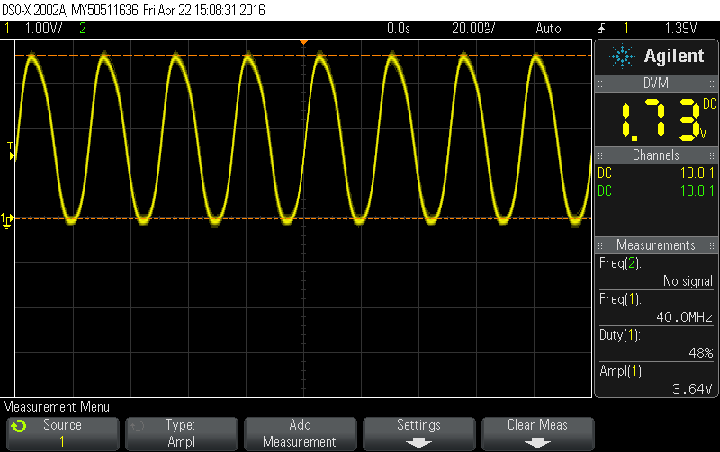

I am using TI Tiva C series board with TM4C123GH6PM microcontroller.i want the GPIO pins to toggle at 80Mhz freq.I tried but the max that i could get was 10mhz only.
Is there any way to toggle it at 80 mhz??

  • Confirmed results:
    Setting the System Clock at 80MHz, the maximum actual GPIO pin output I was able to get was 20MHz (that's full cycles, meaning 40 million level shiftings per second).
    That was obtained with PWM, using Tivaware based configurations.
    Trying twice as much got me nothing but a flat 3V3 output.
    Yes, of course that's assuming really high impedance - I don't rely on GPIO's to drive loads directly except when I'm dealing with really non relevant functions, such as an onboard debug led. Serious things all use external drivers, transistors, opamps and what-not.
  • Final answer:
    No, it is impossible to toggle a GPIO at 80MHz using TM4C123.
    The maximum you can toggle at is 40Mhz, using a timer in PWM mode.

    Note that this signal is 40MHz (full cycles), changing the slope 80 million times per second. Might suffice to what poster needed on first place...
